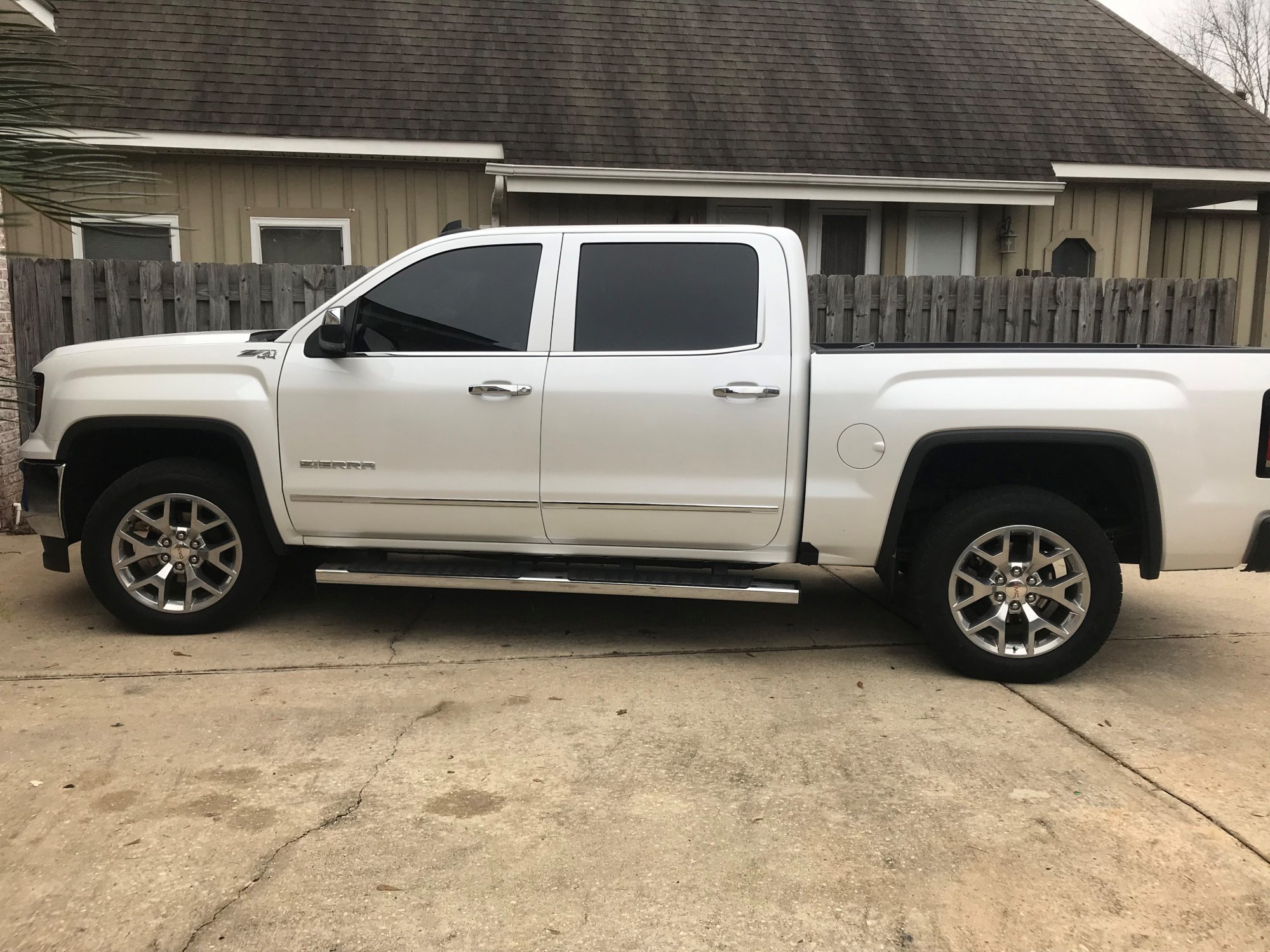

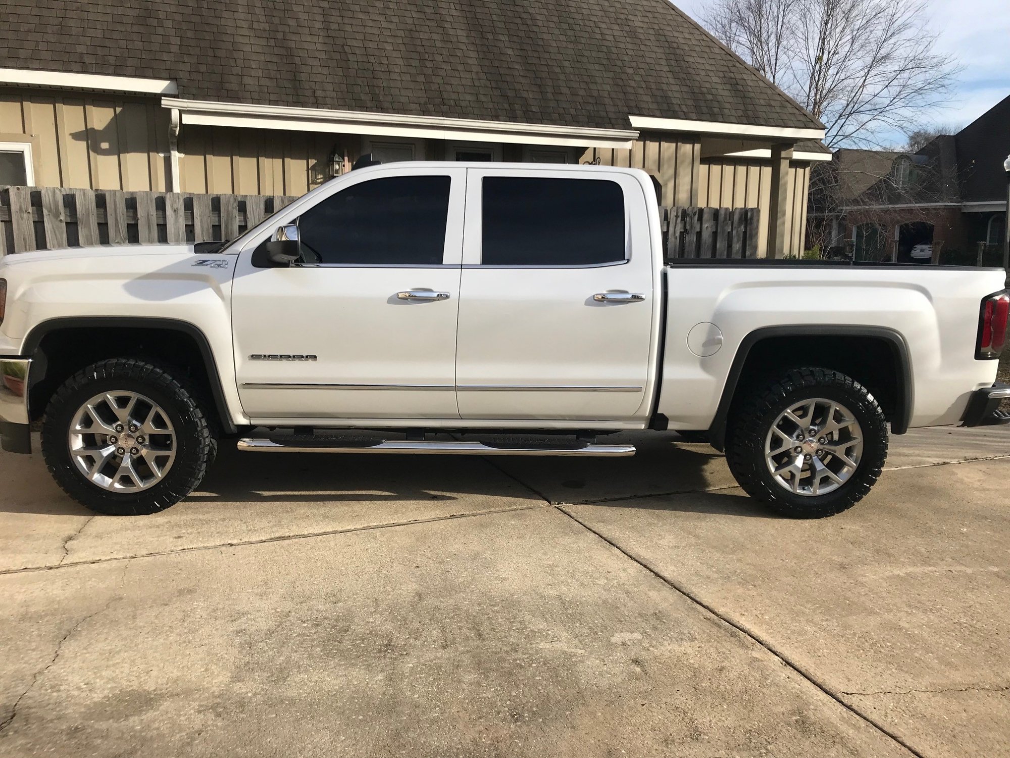

2 inch RC Level front nothing changed in the rear and 285/60R20 Ridge Grappler
before and after
before and after
Nice truck (twin).  You say you did the 2" up front only but in your signature you mention the 2.5.  Did you do the full RC 2.5 kit or did you do just the less expensive option and lift the front only?
