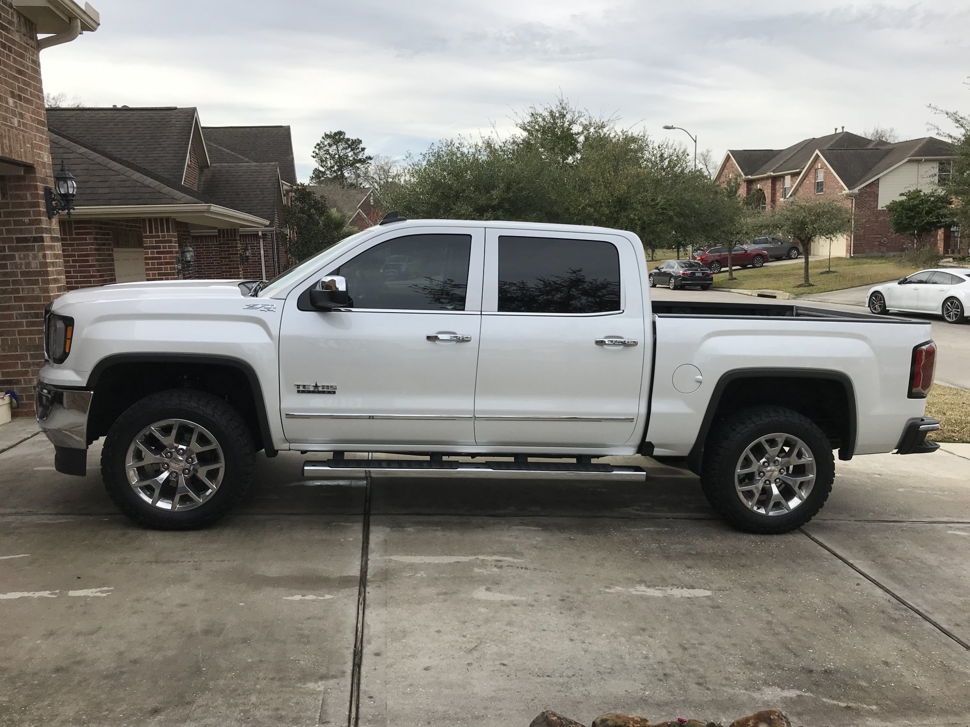

Before adding the new wheels/tires I put a 1/4" thick spacer under the Bilstein 5100s for an extra 1/2" of lift.  I an just under 2.5" level in the front and the truck still has a tiny bit of rake.  Came out perfect in my opinion. Doesn't look nose high or anything.
47258844721_c3602c8b06_k.jpg2019-03-02_01-00-57 by Mike Kubiak, on Flickr
It’s kinda crazy how varied the rake can be from he factory. I would be really nose high at 2.5 inches. To me, mine looks to be almost even with yours, and I only did 1.5 inches.
Yeah, I have seen quite a variation from truck to truck on this site.  Mine is a Max Tow with the heavier rear springs, so I wonder if that makes the rear higher than a non Max Tow??  Therefore the higher level looks better.
That would make sense. Is yours a long bed? I cant tell for sure from the picture, but that could have something to do with it as well I guess
I have the standard 6'6" bed.
