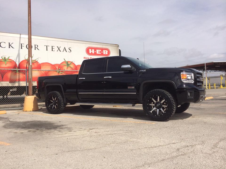

2014 Sierra with 2.5" rough country leveling kit on 20x10 wheels and 295/55/20 nitto trail grapplers. It had a lot of rub at full wheel lock which I fixed by hammering in inner fender where plastic fender trim bolts into inner fender wheel well. Lots of people cut inner wheel well and grind off inner sheet metal to clear tires when turning. Hammer worked for me and cleared the tires. You can't even tell anything was modified. Looks completely stock unlike others who have trimmed there wheel wells on previous model to fit tires. If anyone is looking to do a 20x10 wheel go with 5" backspacing. I went with the 4.75" backspacing since thats the only backspacing they had available in the Fuel Maverick 2-Piece wheels which I like a lot more than there 1 piece wheels. The 2piece wheel comes in a nice gloss black finish while the one piece wheels come in flat black and looks more like an undercoating finish which i didn't like.
A 295/55/20 might work on a 20x10 wheel with 5" backspacing with slight modifications with a hammer like i did. If none/or very slight modifications want to be done to clear the 20x10 wheel with a 5" backspacing go with a 285/55/20 tire. Just my suggestion to anyone wanting to do 20x10.
