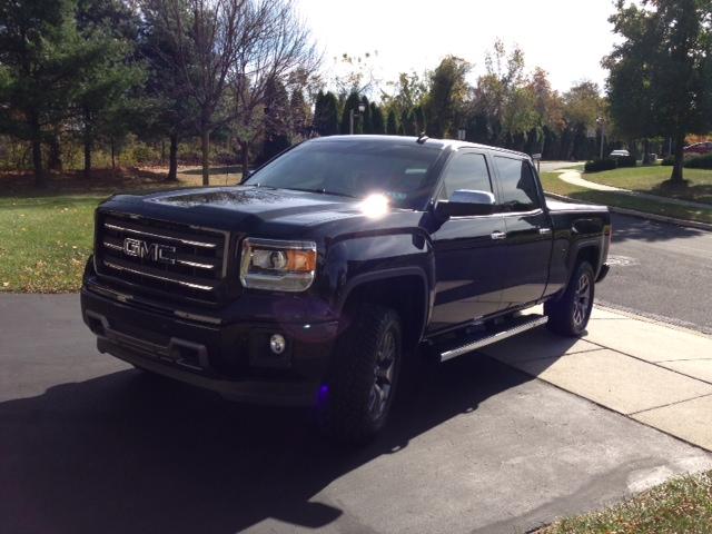

i don't have a before but her is an after
Looks nice. What level did you put on and what size tires are those? Could you post up some more pics so i can get a better look

I leveled the front with a 3" kit from CCm Offroad (The kit I used fit 2007-2014), I also have air bags in the back I tow a trailer and didn't want the back to sag. the tires are cooper neon ltz 305/55r20
I also painted the center caps of the rims to match the rims. De badges and tinted the windows.
