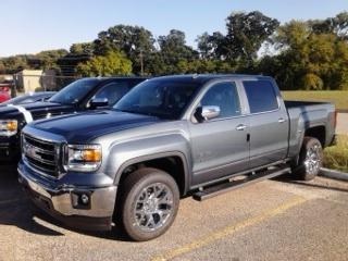

What rear blocks are you using? It looks like it has a pretty big rake.
Can you grab some measurements off the front and rear fenders for us please.
It's not raked as much as it looks in the pic, must have been the way I was holding the camera. Anyway the rear blocks are 2 inch that replace the stock 1 inch blocks.
I really haven't noticed much of a difference mpg. I took it on a trip a few weeks ago and averaged 26 on the hwy. that's with stock tires though. I think I'm going to go with a 275/60/20 vs the 305/55/20, I'm hoping that with the 275's I can keep a narrow footprint and keep my mpg's.

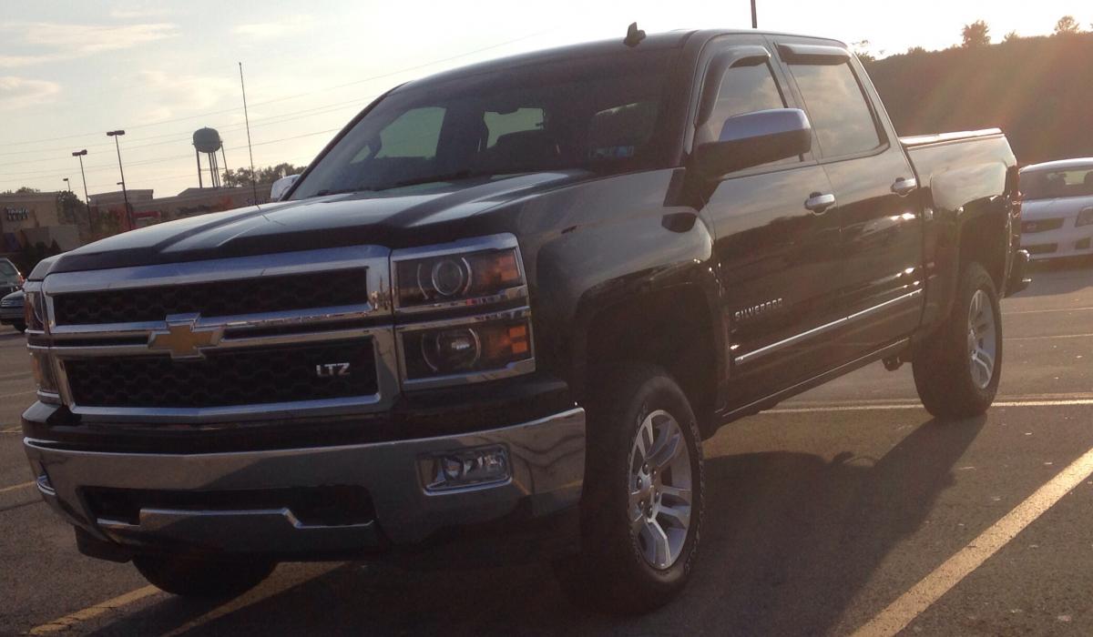

Hey gentlemen and ladies I'm new to this forum.i have a 2010 crew cab silverado LT.i installed a 2 inch level kit on mine.then took it in for an alignment.everything worked out great I have 33 nitto grapplers on it.only thing I wasn't to happy about was.yes it was higher in front but it still wasn't leveled in my eyes.that was with 1 inch specer on lower strut.so I added a a half in spacer on top of strut and happy days.i did not realign but kept a good eye on tires. So far so good. So those of you installing level kits make sure you get kit with top and bottom spacers. Believe me you will be happy! Yes a little bumpy but we'll worth it.
