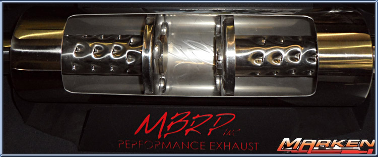

ShamrockShooter Posted January 29, 2017 Share Posted January 29, 2017 So I installed the MBRP kit, but it is way too loud. never thought i'd say that. need to tone it down a bit. the MBRP is a 20x6 inch round straight pipe resonator basically. looking to swap out for another muffler. everyone keeps saying on here they used a 14 inch magnaflow. assuming that will be quieter than MBRP that has no packing or insulation? Do i want the 4x9 oval 14" magnaflow MF series, or do I want the 6 inch round 14" magnaflow MF series? it doesn't list on the magnaflow website that there is any difference in sound between the 14 inch oval and the 14in/6 round. thanks for your help. Quote Link to comment Share on other sites More sharing options...

ShamrockShooter Posted January 30, 2017 Share Posted January 30, 2017 The mbrp I have is bigger than 3 inches so the 3 inch pipe slips inside it. Then you just clamp it. The magnaflow looks like you need to weld it with their universal 14 inch oval muffler. So mbrp sells a "mild" version of the muffler that came with my kit. Going to try that first. Same size so should be a 5 min job to swap. If not will find a shop to weld on the oval maggie. Quote Link to comment Share on other sites More sharing options...

Luster Posted January 30, 2017 Share Posted January 30, 2017 So I installed the MBRP kit, but it is way too loud. never thought i'd say that. need to tone it down a bit. the MBRP is a 20x6 inch round straight pipe resonator basically. looking to swap out for another muffler. everyone keeps saying on here they used a 14 inch magnaflow. assuming that will be quieter than MBRP that has no packing or insulation? Do i want the 4x9 oval 14" magnaflow MF series, or do I want the 6 inch round 14" magnaflow MF series? it doesn't list on the magnaflow website that there is any difference in sound between the 14 inch oval and the 14in/6 round. thanks for your help. The reason the MBRP is loud is because of the straight through design. The inner pipe has some dimples in it and that's all the sound attenuation you get. The Magnaflow has holes in the inner pipe and the casing is filled with steel mesh and fiberglass sound absorbing material. Much quieter. Quote Link to comment Share on other sites More sharing options...
