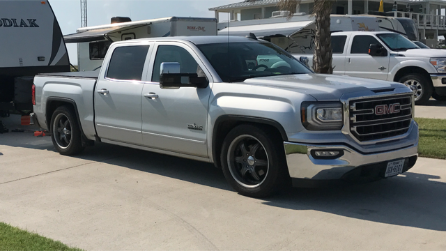

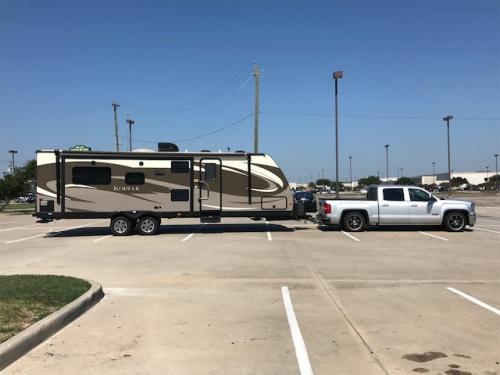

the rake not to bad at all. I had the rear set out 6 inches and was bottoming out when I had the truck loaded down with people. plus I pull a big bumper camper and car hauler too from time to time. here are some pics

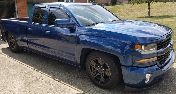

Picked up this 17 about a month ago, first thing I did was debadged it, got some factory painted mirror caps/handles, and black front emblem. Then I ordered a belltech 4/7 kit and had it installed, ended up putting in the 1" lift shackle cuz I like a little rake. Still debating about going down 1 more inch front and rear. Here's a few pics....
Your truck looks great!
