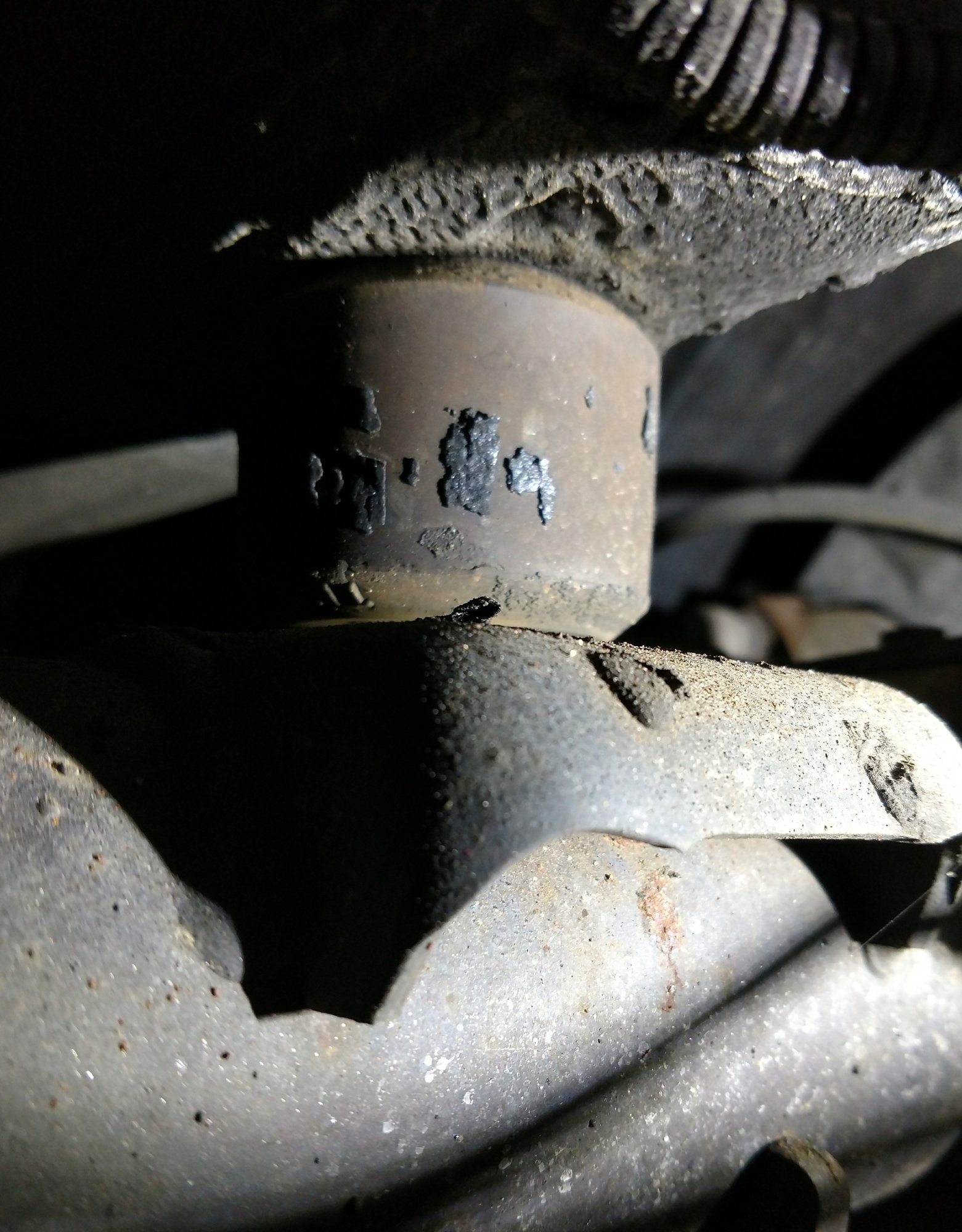

For those of you with a 7" rear drop looking for a good alternative to bump stops, look at Timbren products. I chose their "Rubber Spring" A140-65. It is a 1.885" tall rubber bump stop that has a nominal weight capacity rating of 500 lbs, and has a bump load capacity of 900 pounds. Their maximum deflected height is 1.1875", which means your differential and brake line/hose brackets will never hit the bottom of the bed. I purchased the set for ~75 USD. Just remove your factory bump stop brackets with a plasma cutter or sawzall, drop a 3/8" bolt through the existing hole, and put a nut on the underside. With the vehicle on flat ground at ride height, there is 5/16" clearance between my bump stop and the landing on the axle tube.
This is a relatively simple solution that provides a good combination of load capacity (can still use a half ton truck like a half ton), and ride comfort. I have zero qualms throwing two supermotos in the back of the truck, or hauling a thousand pound load. If you have any questions feel free to shoot a DM. Just something I found and figured I'd share.

Thanks Shaun. I remembered your post about Timbren stops earlier last year while I was looking around at the various options this past week. Just bought an '18 DCSB last week, and it's going in for a 5/7 next weekend. We're notching it and I'm going to keep the Belltech stops on it for now, but wanted to have a better option available if needed. This was it!

These will fit without a notch if you don't want to install one! One less major modification means (hopefully) better resale if you decide to sell the truck off in a few years. Always planning ahead :thumbs:

Are these bolted to the frame or the axle pad? I bought some low profile bump stops from Mcghaughys but I like the design of these better.

These are bolted to the frame. I tried the mcg bumpstops but they blew out within a week. Give these a shot! They're cheap enough. I believe I found them for sale on sdtrucksprings

Cool, I’ll have to take a look. I was under my truck this weekend installing helper bags and didn’t even realize there was a hole in the frame right there. I’ve been running without bump stops for awhile, but I know I need to get some on there. I’m only lowered 5 in the back, so it hasn’t been causing problems but we’re getting ready to get a camper trailer.

Can't honestly remember if there is a hole or not. If not, not a big deal to drill a 3/8" hole for a bolt. ?
