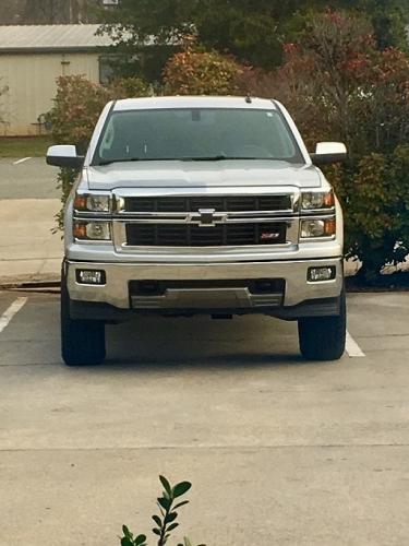

No rubbing at all
Do you think the 2" leveling is necessary, or could one get by with less or no leveling?

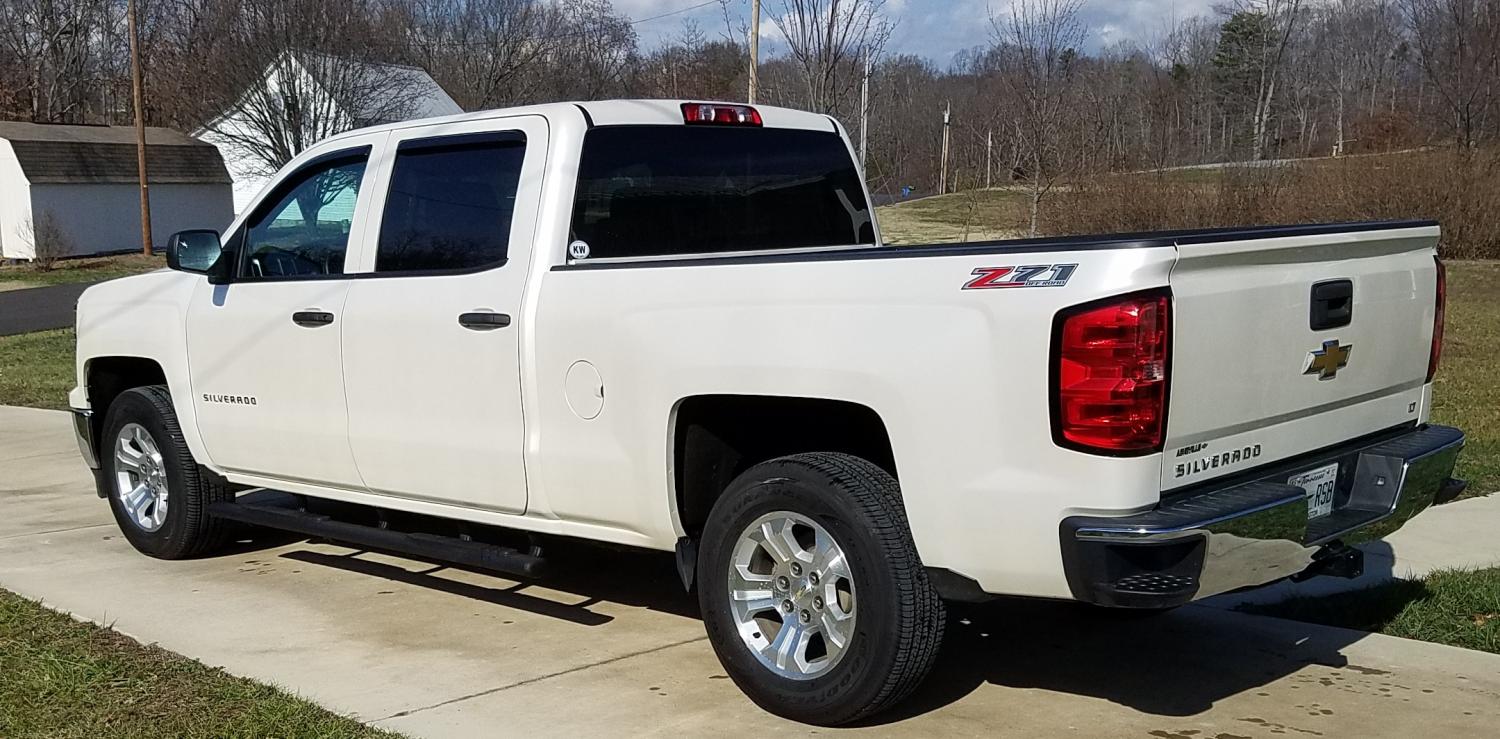

20" Chrome OEM Replicas 20X9 on 275/60R20 Nitto Terra Grappler G2. No level, no rub. 4a5ea113454eda33248d2fa3c67a3494.jpg
