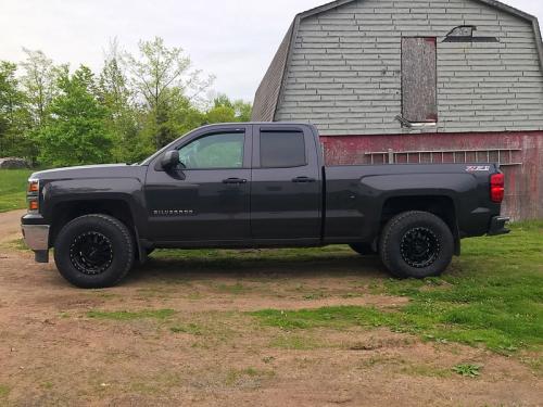

Toyo Open Country A/T II LT285/70R17
Black Simulated Beadlock Vision Nemesis 17x9 -12
Wow, those look good, time for me to place my order. When you get a chance, post up of few more pics. Did you order those in a tire and rim package and if so, where did you order from. Thanks
Looks good. Any lift or leveling?
no lift or level yet, slight rubbing in reverse but its just the liner. I have a 2.5 level I just haven't had the opportunity to install it yet.
I ordered them from https://www.customwheeloffset.com/ they have the best wheel and tire prices. I paid 1490 mounted balanced and shipped to my house. Shipping is free. I literally took them off the pallet bolted them up and drove away. The balancing was great and haven't had issues thus far.
