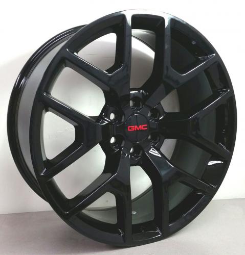

I am torn between these 2 options, both 20's.....
I vote the GMC wheels
22x9 GMC replicas with 285/45 R22 Bridgestone Dueler Alenza Plus.
The stock design looks better but they have too much offset (+27), in my opinion. Sit way too far in the wheel wells. The higher offset really exposes the fact that the rear track is slightly more narrow than the front. For that reason, I'll always vote for aftermarket wheels with much less offset, with anywhere from 0 to -12 being the sweet spot for me.
Those little bolt holes on the bottom wheel would be a biatch to clean out! Imo.
