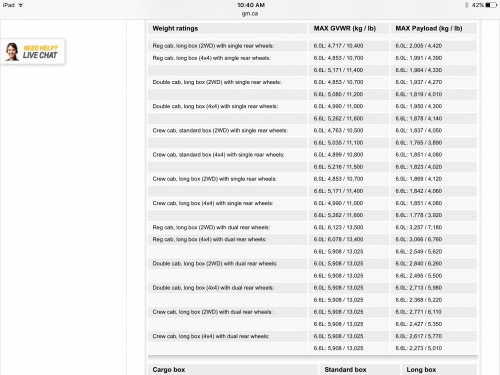

I have a 2016 3500 Dually 6.0 in transit right now and I will say what so many have already said. I want to stick with a proven engine and in my model, the 6.0 gives me a 5770 pound payload, 760 pounds more than the Duramax in the same model which has only 5010 pounds. I really need that exra payload. See the bottom line in chart.
My 2008 Dually Duramax only has a 3700 pound payload and my camper with 2 slides has a dry weight of 4100 pounds.
In every model, the 6.0 gas has a bigger payload than the Duramax, quite a bit more in DRW models
The last time I bought a new truck with an unproven track record was my 2004 F350 with the infamous 6.0
Powerstroke. Now that is the 6.0 that is still called the sick-0 in many circles and after getting hauled in 3 times, it made a GM owner out of me and I will always be grateful for that.post-151531-0-66531000-1450066333_thumb.png

Just remember that how the truck is optioned out will change the payload. The max numbers are typically on a WT trim with no options. Higher trims usually lower the payload and occupant and cab payload will affect it as well. Make sure you check the tire placard for the true max payload when it arrives.
Thanks for your reply. I do know that everything put in a truck weather it is people or options is part of the payload.
4x4s have around 330 pounds less payload in the same model 4x2 as you can see in the chart above.
The steel wheels on the WT models probably weigh more than the alloy wheels on the higher trim levels and the option that lowers the payload the most is the Duramax, in my model, it takes away 760 pounds of payload.
The bling and other electronics in the High Country trim I ordered is small potatoes compared to that.
I really like my 08 Duramax but from the research I have done, I think I will like the 6.0 gasser. My new Dually has a
13025 GWWR and I should be around 12500 all loaded up. My 08 Dually has a 11400 GVWR and even loaded light with only 1/3 tank of fresh water, I was 1000 pounds over that.
Both Ford and Ram have DRW models that give me the payload I need with Diesel engines but I wanted to stick with GMC so I had to go gas. Without starting a new topic, does anyone know the approx numbers of 6.0 gas engines that GM has made. The Dmax passed the 1 millionth mark a while back. Just curious.
