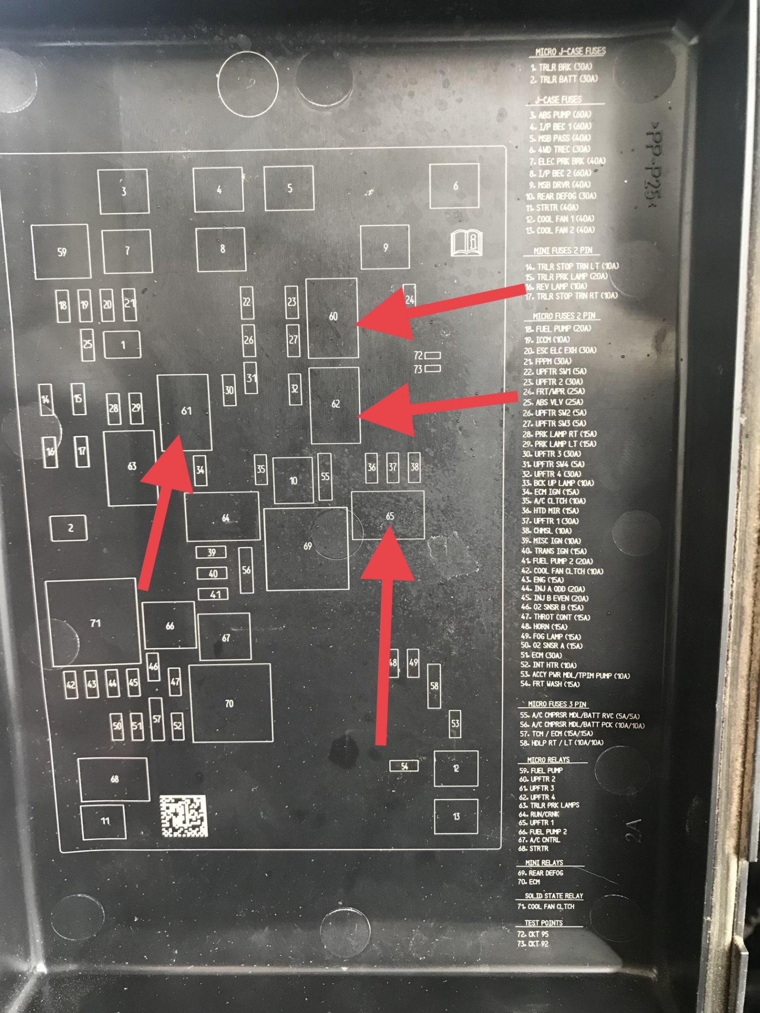

can you snap a picture of your underhood fuse box, specifically where Upfitter relays 1-4 would plug in. (#60,61,62,65) I want to see if the pins are present for the relays. ( if it’s just a blank cavity or if there’s a metal pin inside to contact a relay)
Sorry, just read you only have TC, Cargo, Aux1-4
On the same page now

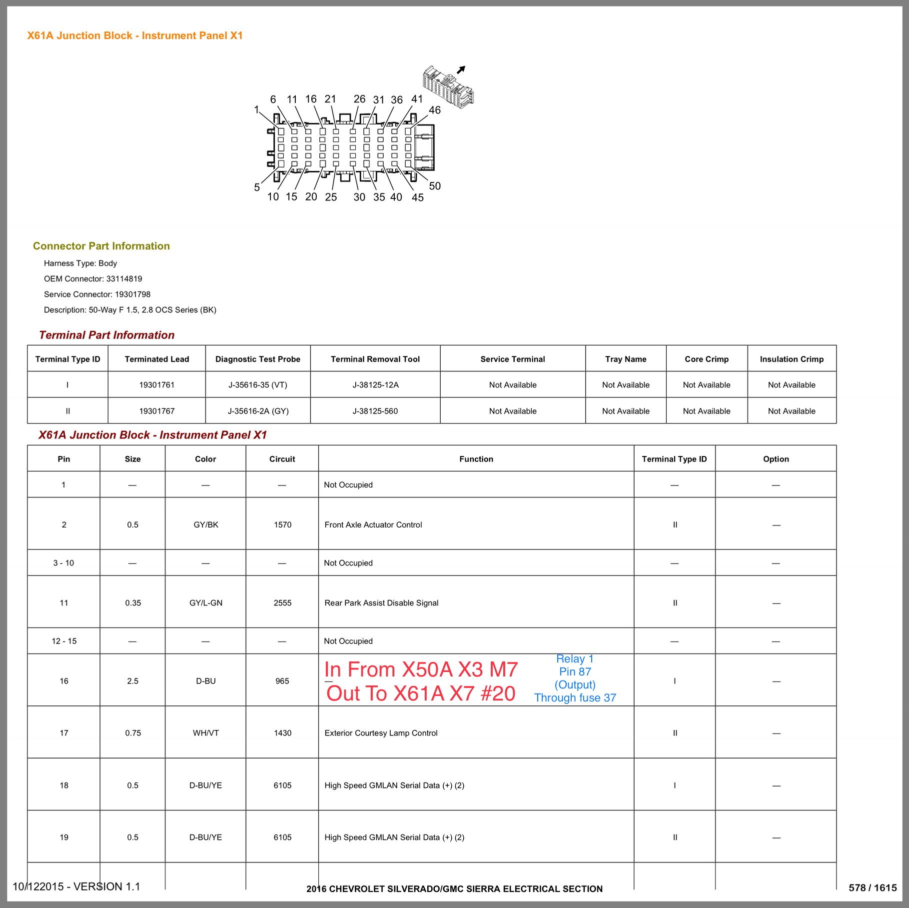

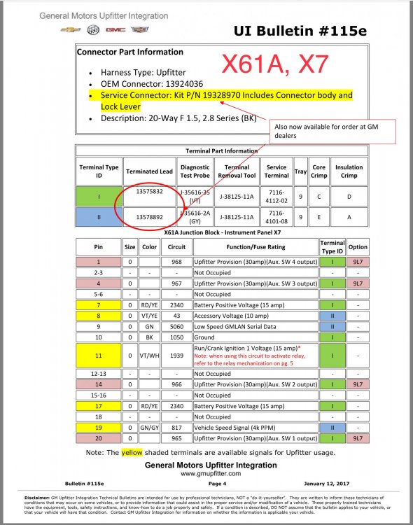

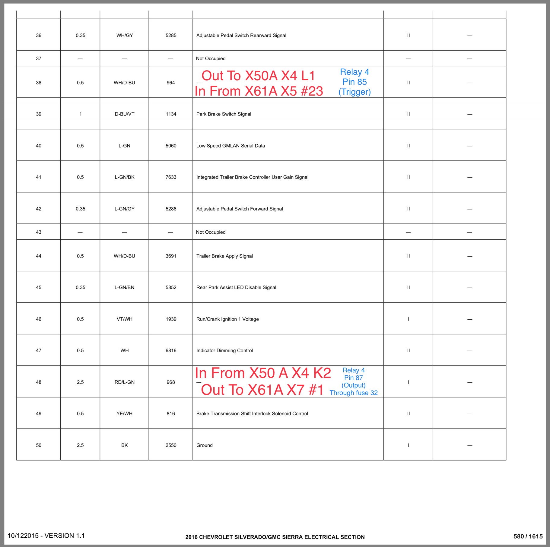

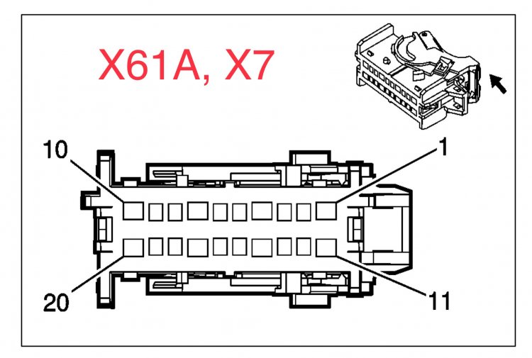

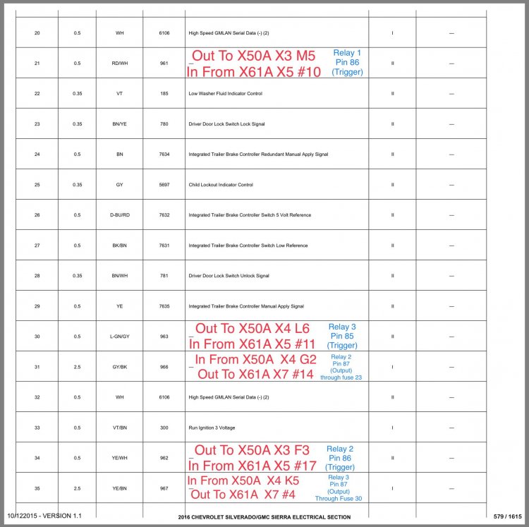

The OEM wire routing would go from the S48A (switch panel) to the X61A, X4connector(Junction box behind brake pedal) then out of the X61A, X1 connector, and into the X50A, X3 & X4 connectors (under hood fuse box) your accessory power or output from the relays will come out of the X50A (fused) and back into the X61A, X1 connector and out of the X61A, X7 connector.
These pictures show the routing in and out of the X61A junction block behind the brake pedal.
Please note: in Gm Upfitter there is a discrepancy between 2015 and 2016 model years pertaining to where the wires from the S48A (switch) land at the X61A (junction box). They land in either Connector (X4 or X5). Simply verify by checking the location and color of neighboring wires to be sure you’re on the right connector.
This may be due to a type-o or different wiring on different model years. .......still sorting that out.
Edited by TinkeringFox
Said X61A x4, meant X5
  • Thanks 1
Here are some more showing the X61A, connector X7
  • Thanks 1

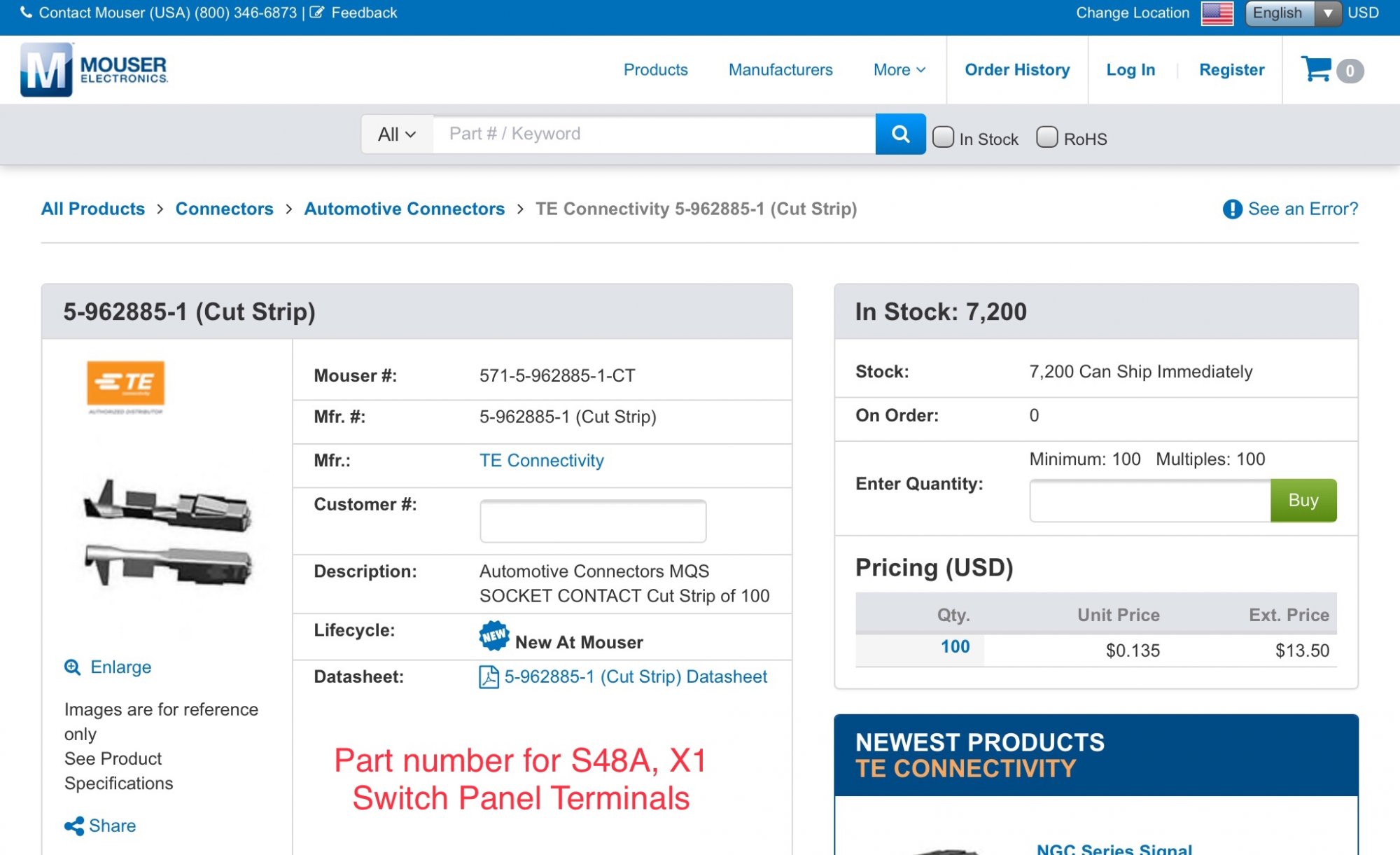

Here are the part numbers for the terminals for the S48A switch panel connectors X1 & X2. This will save some cash.?
Wrong Text on pic 1
  • Like 4

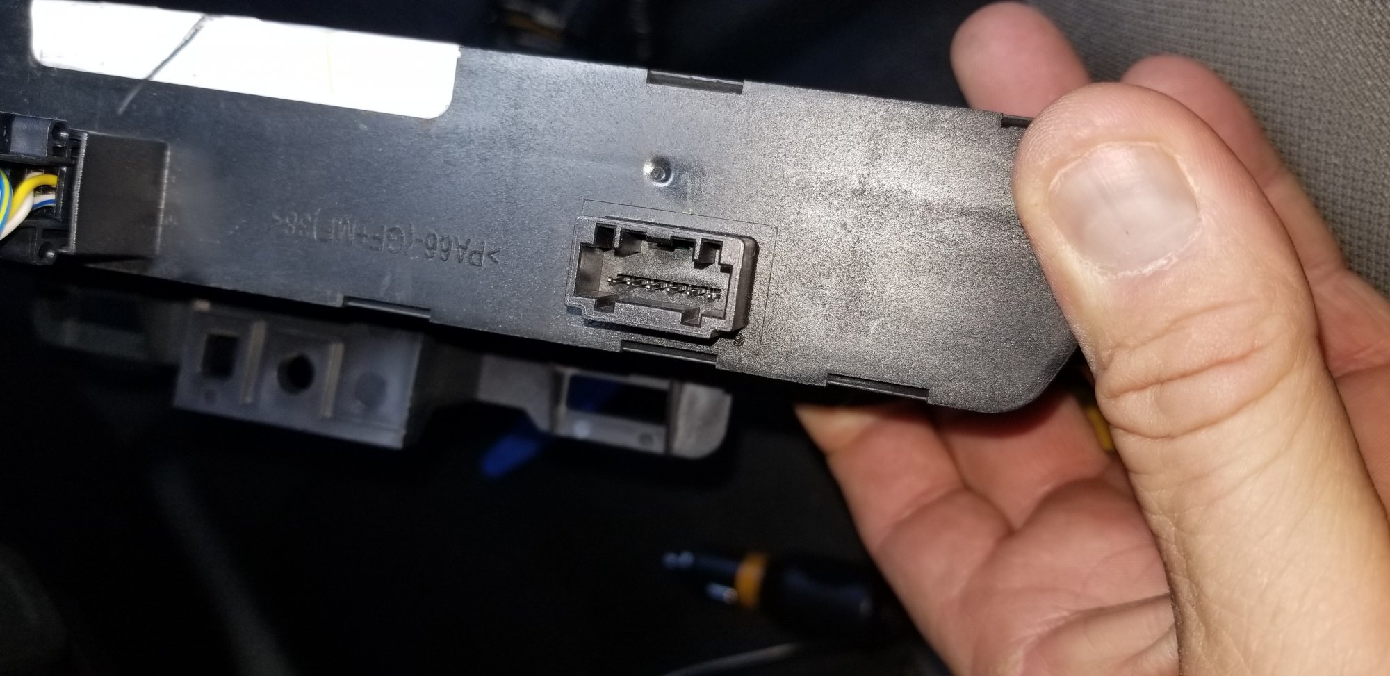

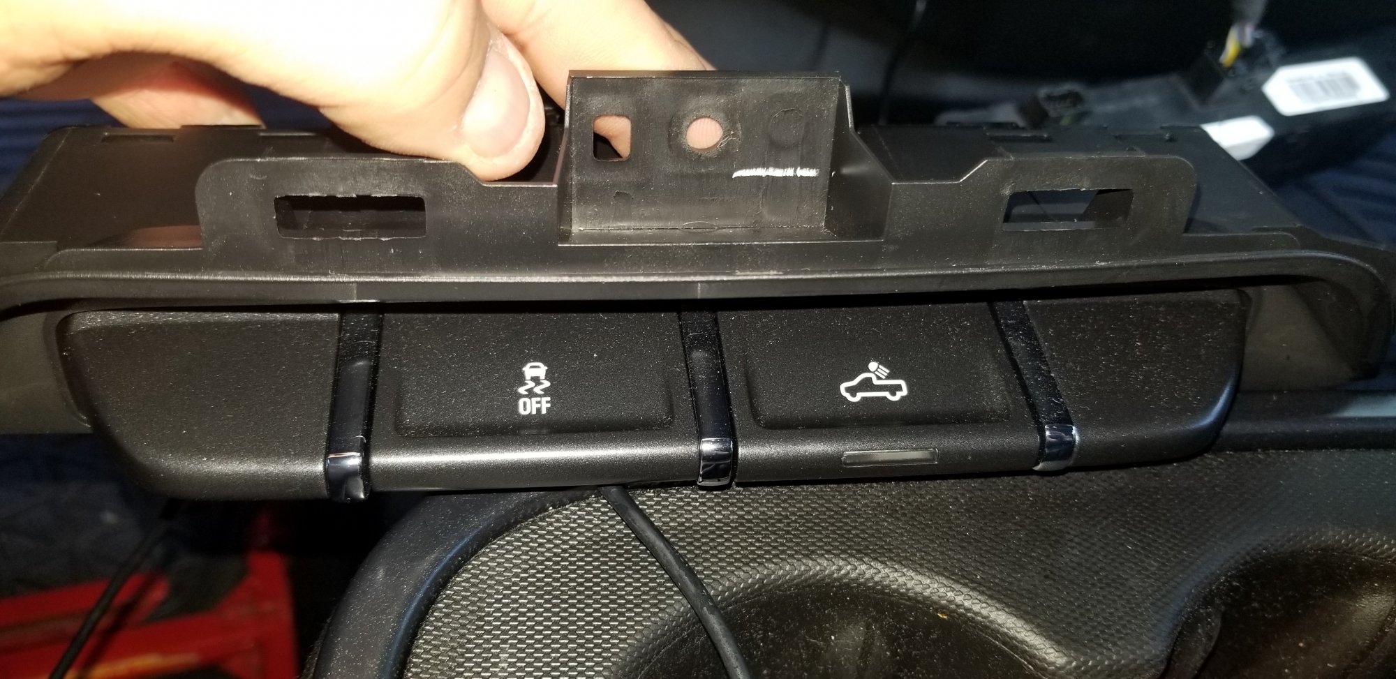

I have an X2 connector with 5 wires but the factory cavity on the module did not have any terminals.
Now the new module has 5 terminals. What is the connector for?20180912_185832.thumb.jpg.9c2825b12087fcbd5ba092bb4689fb2a.jpg
