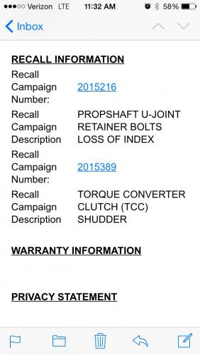

Anybody get an email like this today? or Recently?
2015 CHEVROLET SILVERADO K15 CREW CAB VIN #3GCUKSEJ7FG230213
RECALL #2015389 TORQUE CONVERTER CLUTCH (TCC) SHUDDER (NO PARTS)
RECALL #2015216 PROPSHAFT U-JOINT RETAINER BOLTS LOSS OF INDEX (PARTS - NEED TO ORDER)
To keep your vehicle in optimal condition, we have factory trained technicians at Universal Chevrolet Co Inc that can take care of this recall for you. Once the parts are here it will take about 3 - 3 1/2 hours to fix these recalls for you.
Our Service Department is open Monday - Friday 7:30 am - 5:30 pm with extended hours on Tuesday and Thursday 7:30 am - 7:30 pm.
You can either respond to this email regarding a time which works best for you or, you can contact me directly at 919-365-6351 to set up a time for you to come in.
Thanks again for choosing Universal Chevrolet Co Inc for your vehicle service needs.
Perhaps GM has finally figured out the cause and developed a fix for it????
I asked about the #2015216, I was told it's not a valid bulletin number. Wonder if it's preliminary?
Never really heard of a prelim. service bulletin or any information being released prior to just sending the actual bulletin to dealerships.

i had the bolt recall done yesterday. no more pop forward when coming to a stop.
the number is not a valid bulletin number because it's not a bulliten, it's a recall and if it applies to your truck it will come up when they run your vin, otherwise don't sweat it.
I had the T/C recall done too.. is that what you are referring to? (What is the "bolt recall")? I still have the luching forward when coming to a stop issue even after the trans recall update.. I took it back and they said it was too intermittent to properly attempt to diagnose, but "relearned" the transmission.. it was a lot better at first.. but now doing the same thing (but very intermittent.)
Thoughts? Anyone else experiencing this?
Two separate recalls. Driveshaft or U-joint bolts.

I wasn't aware there was a recall for the Driveshaft and U bolts.. only torque converter software.. I did a check and those recalls did not show up... Guessing it is not listed as a recall for the 2015 Silverado 6.2l 8sp?? Did it help the lurch forward or banging into 2nd gear?

Just got this email but I wonder if I need to get it done or not since I had my transmission replaced already what do yall think
