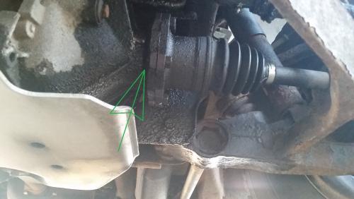

looking for temp solution for bad differential bearing
I have a 2002 GMC Yukon XL 1500 4x4. it has 185k miles. I need to get a few more miles out of it because i am on road away from my garage.
I noticed a metalic clicking that seemed to be coming from the front drivers side. I assumed the CV Axle was toast.
after looking at it, the CV axle seemed to be ok. however, the output flange on the drivers side has noticeable movement. (when I grab the inner part of the cv axle and check for play or movement, the only movement comes from the output flange)
My question is this. Can I disassemble the cv axle leaving the outer cv axle in the wheel, (I understand this is what hold the wheel together)
Are the bearings on the outer part of the cv axle just for the cv axle?
Are there are still wheel bearings on the spindle?
I know this is bad practice but i would like to know i can make it home and fix it correctly when i get there.(about 1000 miles away)
Or is all this unnecessary and would it be ok to drive this distance with the (i think its called) carrier bearing failing.
The green arrow on the picture is where the play is at.
