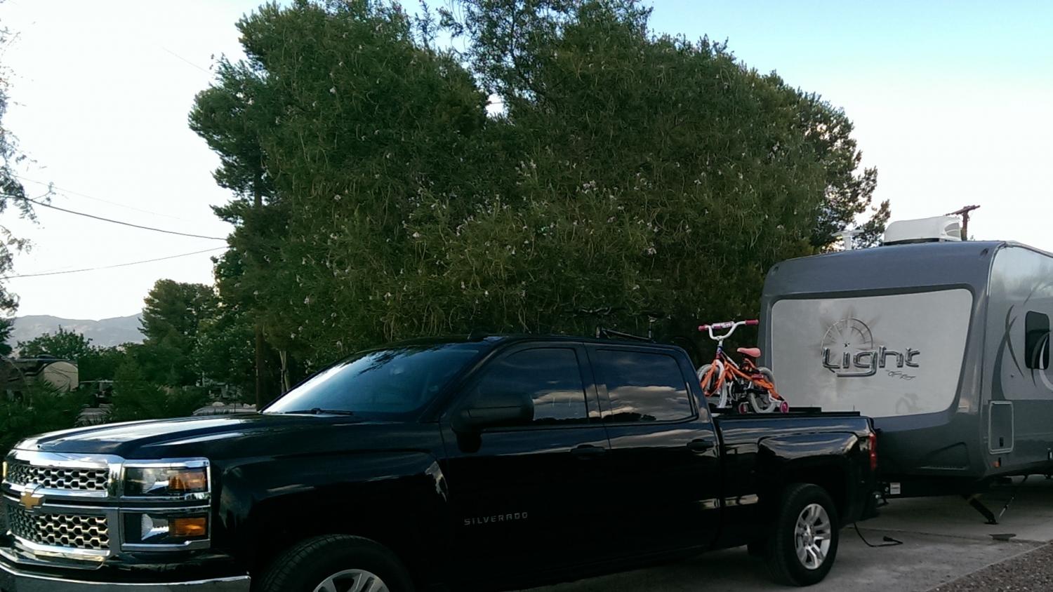

This is an Open Range 308BHS. We love it. Pulled it so far from Indiana to Los Angeles, and Los Angeles to Alabama with dozens of stops in between. I have around 40 nights in it within the last 12 months, and it's holding up to the abuse of my wild 4-year old girl, dog, cat and wife who has a nasty door slamming habit.
Highly recommended. Scaled at 9600 on our trip from LA to Alabama.

Nice TT , can I ask how you thought your truck pulls the TT ? I'm wanting to get a toy hauler {5400lbs} and would like to hear from others that have a 1500 pulling a trailer. Are you using a weight distribution hitch and what brand ? thanks in advance

I'm using a propride WD hitch. I bought it used, and wouldn't use anything else for towing something that long and heavy that is not a 5er with a 1500 especially. Sway is non-existent. I took it through the Eisenhower tunnel at 11,000 feet in Colorado, so if it can do that it can do anything anywhere else in this country. @ 55mph, I get between 10.5 and 11mpg. @ 60mph, 9.5-10mpg. 65mph, 9 - 9.5mpg.
I also have a TPMS on the trailer to monitor the tire temps/pressures. Knowing that I'm towing at the limits of a 1500s capabilities, I did everything I could to increase my safety margins and make me feel comfortable behind the wheel towing the trailer. I also did not upgrade the receiver. My tongue weight is in the neighborhood of 1100-1250lbs.
