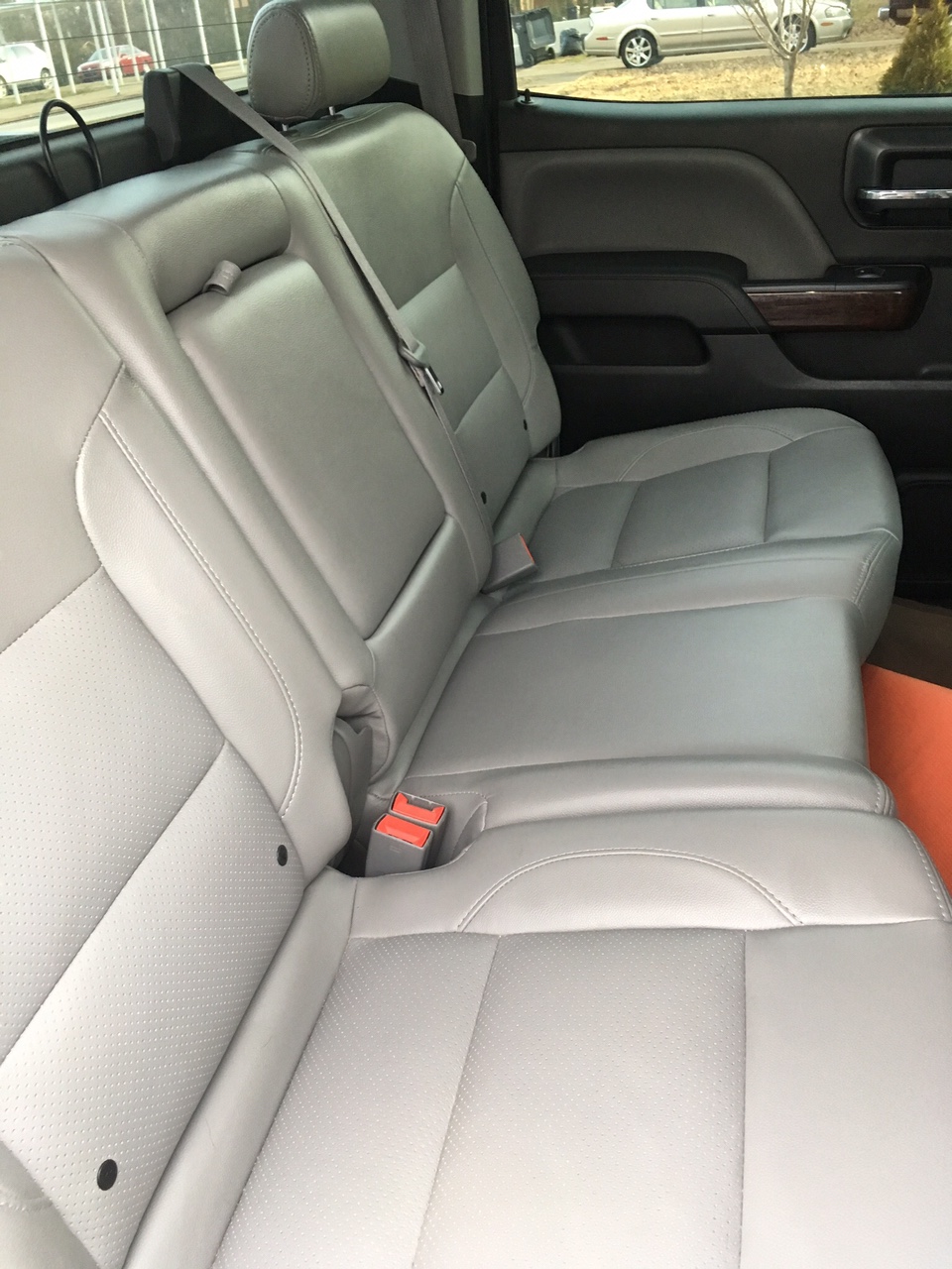

I did my truck and loved it. Got a warranty for mines, just Incase anything happened. Nice job
Install went well. Had some trouble with the seat bases for front seats. They were out of square a little. I would say make sure you have Staples. I thought I had some but couldn't find them. The videos I found were definitely helpful especially the jump seat.
My biggest issue was figuring out how to get the seats out without breaking anything.  Once I did one the other wasn't too bad, but figuring out how to get the first seat out without breaking clips is tricky.    You also have to go slow, it seemed like every single weather pack connector was different and had a different way that it unclipped.
Yes, the center jump seat is an absolute pain in the A$$.  I probably spent almost the same amount of time on the jump seat as I did on the actual cover install on the other seats combined.  I would have never been able to do it without the videos I found on  youtube.
