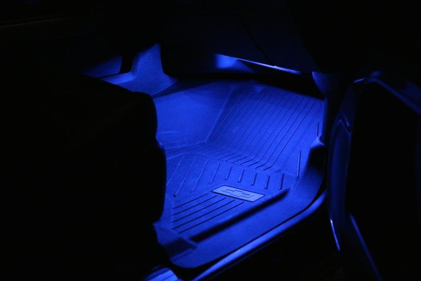

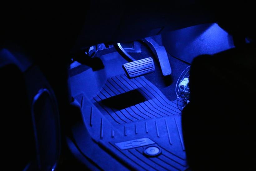

I'm loving my new footwell lighting!!!
bholden
Nice lighting. Is that factory? If not how is it done?
Jim
No it's not factory....I wish it was ...lol but this is what I used 61fa5b942289f8c269fccdfa559b7cf1.jpg
could you please post a pic of where you have it plugged in. do they all connect to 1 cigarette adapter? thanks in advance.
I'd like to see where you mounted them and how you have them wired to the truck and pictures of under the seat would be nice, thank you.
Yea I could take some tomorrow for you guys

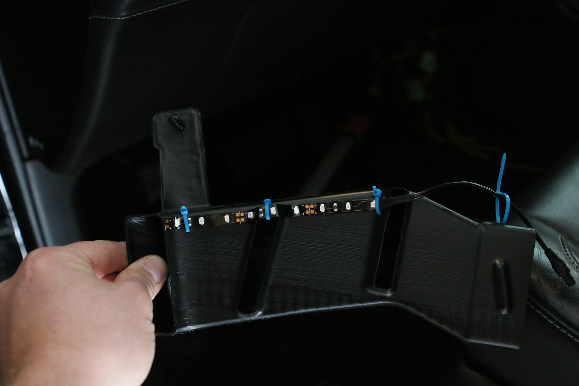

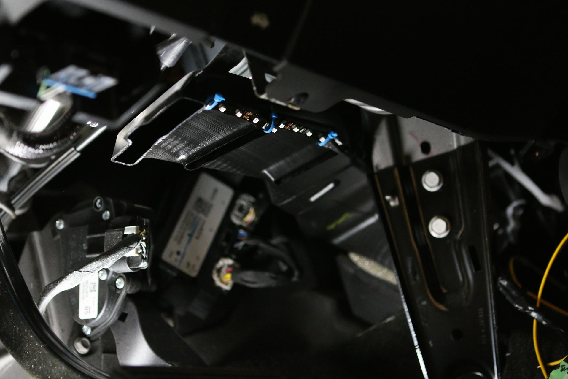

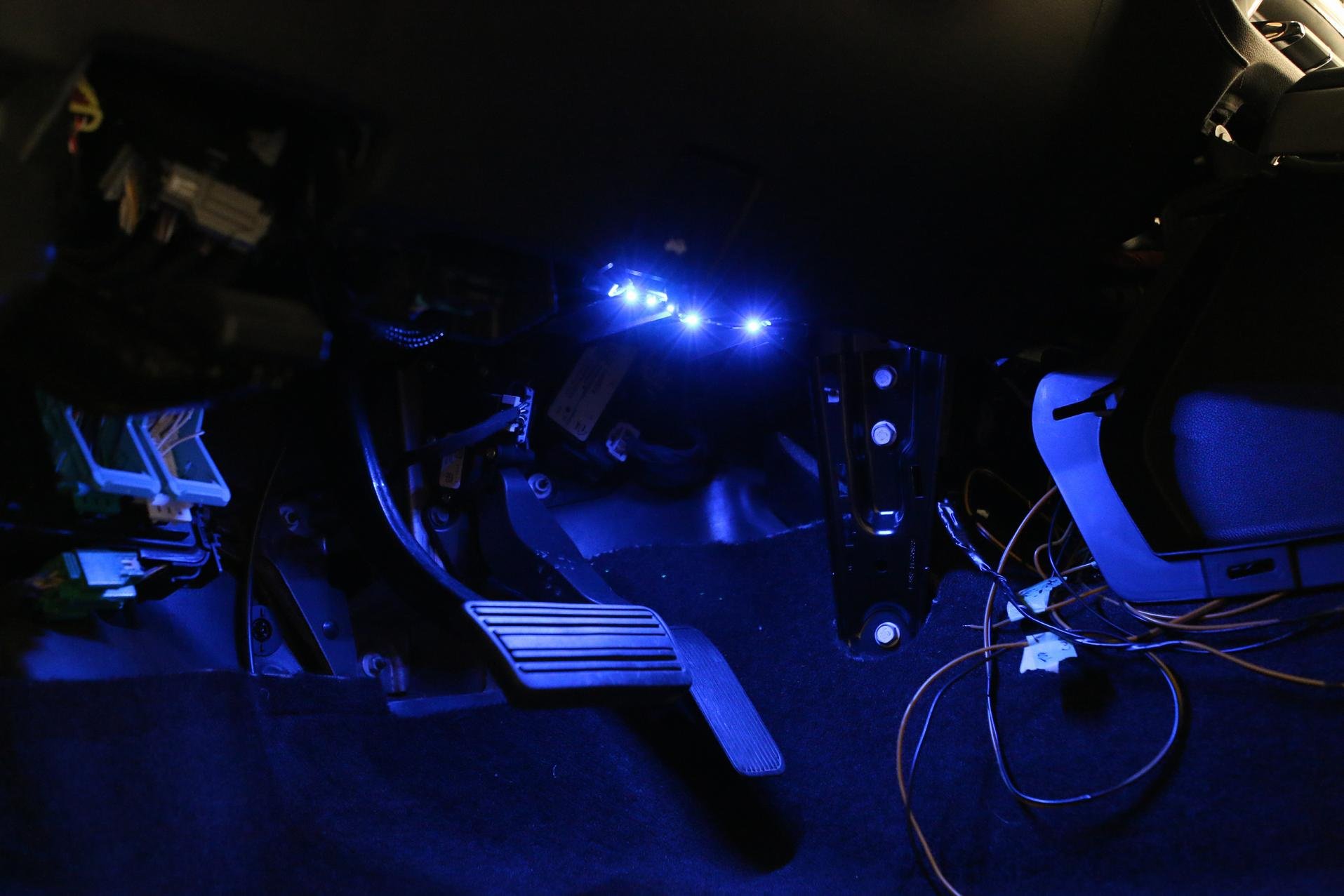

on my drivers side i attached my LEDs to a heat vent:

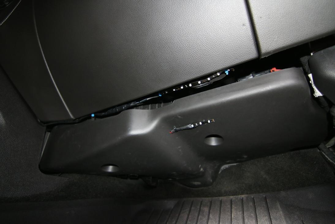

on the passenger side i went right below the glove box.  the 'short strip' is for my ambient lighting:

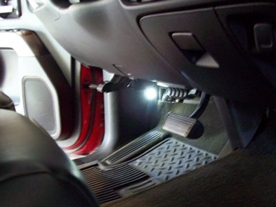

Mine aren't near as cool as bholden, but they do the trick for me.
I was looking for some marker lights, ran across these on eBay
I think I got 30 for $11.99 or something like that, used the white's for inside.
Surprisingly bright.
Takes a 3/4 hole that a rubber grommet fits in then just push the light into the grommet.
Wired these into the bcm interior light wire...I think it was gray/white stripe...but, don't hold me to that
