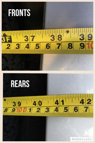

I ran down to my local truck shop and was discussing about adding 2'' informed him i was looking into installing the Bilstein 5100s as I read where ppl love them and I can adjust from 0-3" ...well we got to talking abt different possibilities and he said I should just lift the front with some strut extensions and call it a day and would be level with the rear got me thinking well when I went home I measured the fronts and rears and as you can see my fronts are abt 3'' lower from my rears ....I install those strut extensions I'm still going be abt an 1" short in the front and but if I install the Bilstein 5100 I should be abt even with my rear if not off by 1/8 give or take .....should I just stick with my original plan and run with the Bilstein 5100s or get the strut extensions ? .......
Bilstein alone won't get you 3", they are between 1.8 and 2" is what everyone is saying (some of the other models like Tacoma can get closer to 2.5). Going 3" will be awfully hard on your front end suspension and components and cause premature wear. Plus going exactly level tends to make these trucks look a little nose high (even though it isn't it will look it). Put a 2 inch spacer in, keep an inch of rake to help anytime to carry anything and it will be cheaper. If you go the bilstein route and have them all the way up they preload the spring and it will ride a little rougher.

i have spent some time n days combing though hrs of similar post...wasnt fully going to extend the bilstein was just saying just wanting ppl opinions on each pros n cons
