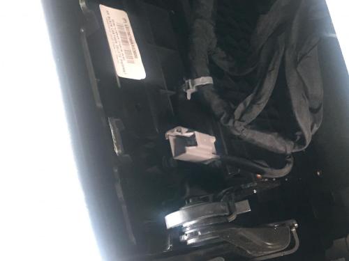

I have more photos of this plug but the file is too big to upload from my iPhone.
However based on photos of the plug from eBay listings for console lids with the charger it appears to match perfectly. I have a 2015 Yukon XL Denali first production. It seems like the car was prewired. Wires are purple with yellow stripe/Black/Green from another thread the green is supposed to be the wire for the BCM to show the charging on the intellilink display.
