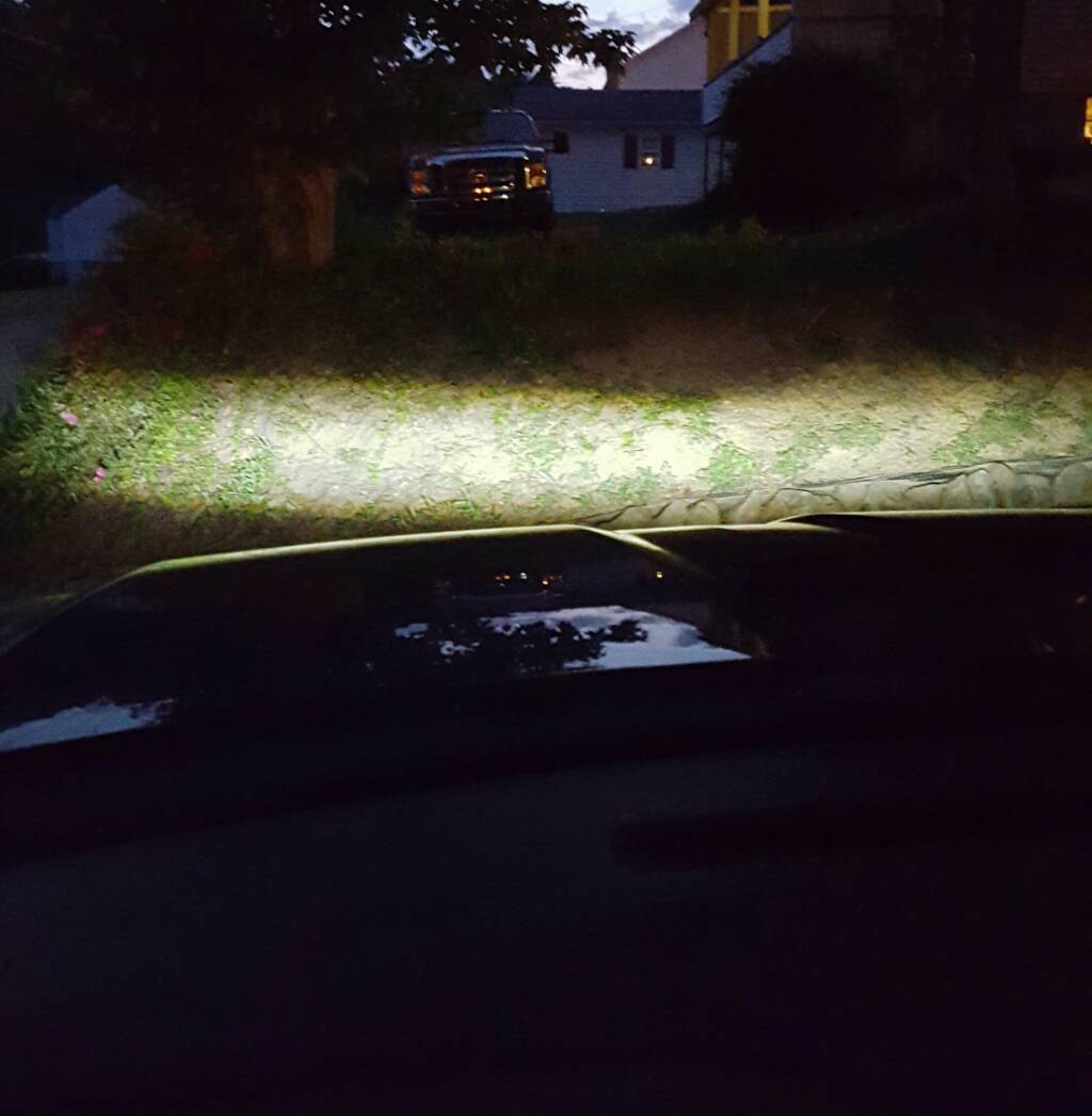

Still the middle of the day but they definitely light up the shop better than any of the other lights I've had in there. Worst being the Diode Dynamics, then stock, then Putco's blue Halogen bulb. These give me hope LED lighting may be able to tangle with HID's at some point.
Headlights are 4500k DS2 and the fogs I believe are 5500k. I'm still not sure why LED's only come 5-6000k for automotive. Anyways this is the best "color" difference I could capture with the phone camera.
