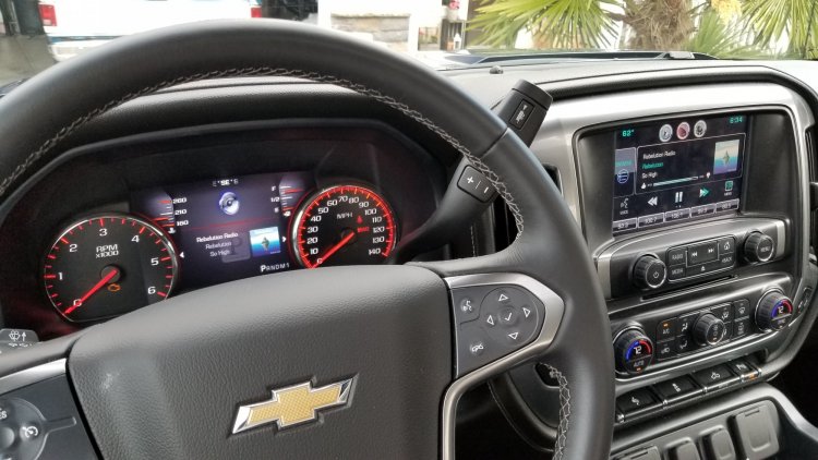

Thanks to Chris White for the programming! Got the cluster in today and everything works exaclly as it should. Side note, i seem to remember a part of this topic mentioning the speed limit sign being displayed on the cluster on the later model trucks. I have a 2015 Silverado 2500HD LTZ and still get the little speed limit sign displayed next to the PRND indicator on the display and not just when I'm in the speed limit page. Just FYI.
The only difference I noticed is that the weather advisories don't pop up in the Denali Cluster.

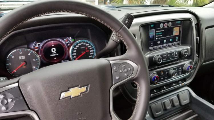

Well since I can't leave well enough alone, I decided to go a step further and make a "hybrid" cluster for myself. Since the 2015 clusters don't have options for the chevy blue in the screen, I knew that couldn't be changed. So I decided to at least make my gauges the chevy blue to try and include some of the color back into the cluster.  Turned out pretty good and I'm really happy with it.
Do tell how you did this...in a separate thread. Just link it here.
Oooh... maybe swapped in the blue gauge faces from another cluster?
Here you go, made a "how to" on what I went through to accomplish this setup.
I’m thinking that’s the case. However, I thought the faces were glued on.
He actually just posted a detailed how to on this. Swapped LEDs from a Cruze Cluster. :)
The faces do have an adhesive that keep them on the white difuser but you can pull them off pretty easy. It seems to be more of a double sided tape than a glue
Edited by corwest
That's half of it. The problem was that the Denali cluster has red LEDs backlighting the red faces so both had to be swapped.
Ah yes. Don’t wanna miss that detail. :)
Update to this project. I can confirm that the servo boards from at least a 2017 cluster will swap over to the 2015's. So those of you with more money than time can simply swap the boards and faces from a 2016 with blue or 2017+ cluster. That makes this about a 30 minute job and much easier. and for what its worth, the screens are also interchangeable as well. No that you gain anything from swapping them.
