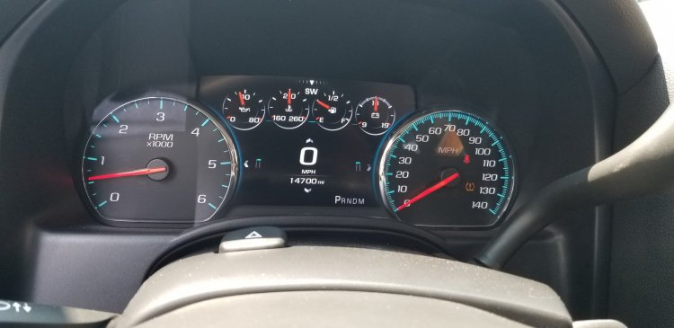

Thanks appreciate the help guys. Luckily I went back just to confirm the part # and came to find out the cluster has a small crack on it which I didn’t see the first time. 17B08B6A-E25E-49FA-A9DC-EF7E1674B9A8.thumb.jpeg.58ec62229c061ca496ab40b9013653cc.jpeg
You can pull off your plastic face and swap with that one
I tried that but the plastic faces were different.
