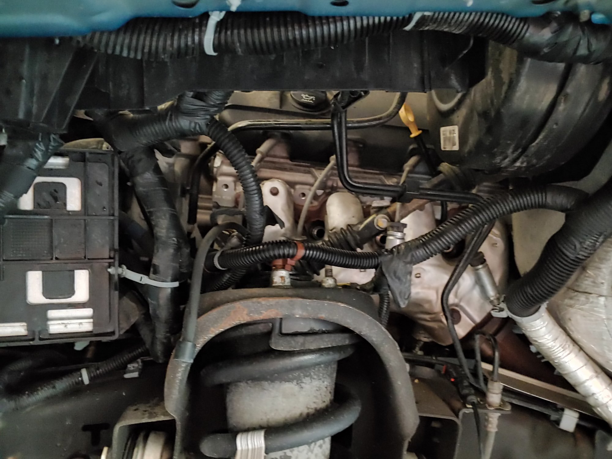

I changed them this weekend. I removed the fender liners and it was so easy. 45 minutes to do both sides. 15 minutes to put on new belt tension-er arm and belt.  I probably should have rotated spark plug for the picture. Didn't notice until after they were in the trash. lol  They llooked great for 157K on them.
This is on a 2015 GMC Sierra 5.3lfender.thumb.jpg.dfb7efe450c3f301d5c7d83eab4db8a1.jpgplug.thumb.jpg.e06f5cf61b8b5cd48f2fc5ebeff94e68.jpgtruck.thumb.jpg.2e16c622a5ff96264f1a346b349c9e5b.jpg
Removing wheel well liner is the way to go! The 5-10 minutes to do that saves you more time in the long run, plus no aches and pains from torquing your fingers and arms to fit in those tight spots. It's a straight shot into each spark plug with the liners removed. #8 is still a little hidden, but not bad to get to. I'm assuming you kept the plugs stock with ACDELCO? You do the wires too? I kept my plugs stock, but went with Taylor wires. Smoothed out a small rumble at idle with the larger Taylor wires (6.2L), wasn't awful with stock wires though.
