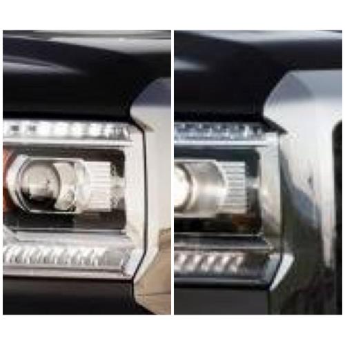

I think a 14-15 1500 would also have a gap. From pictures of 1500 and Hd looks like the chrome grill surround comes up higher on the and just slightly. Im going to go check some out at the dealer to see if they are before I get into this mod. HD grille is in pic below on right 1500 on left
