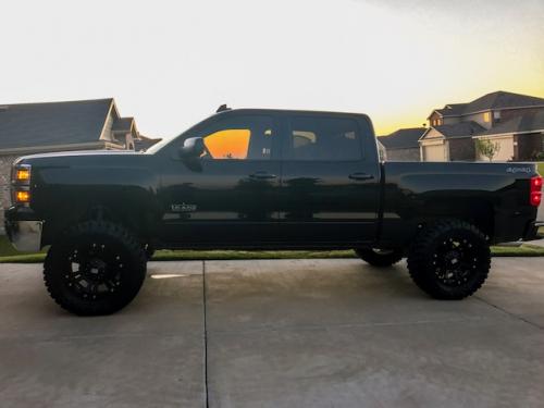

I took mine off because even at creeping speeds it would drag through large potholes in parking lots or mudholes in gravel roads. It definatly has more of a truck look with little gas mileage loss. I kept it but not sure why. fba46735f2265a4eb9f56960e7308916.jpg
