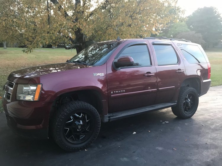

GM ran out of money on these. It simply cost to much to manufacture them. The published subsidy amount was 15k per unit to build them over the sale price which was already a lot higher than a std unit. After snooping around this one i would guess that the subsidy amount was way higher than the published 15k each, this is some friggin amazing technology, everything works on this high mileage unit even the dvd player LOL.. MSRP of over 54k.when new I gave the previous owner less than 7k for it and they had recently spent 4k on a 3.5" lift/wheels/tires and front end work ball joints etc.  Hybrid battery is a 300V module under the second row seats. I have a few pics.

Your right that is some amazing tech plus its more than a decade old. The battery, how long was the warranty? Cost to replace battery now if available? How long were they made? I know there is a law that parts have to be available for so many years once production ceases. Finding someone to work on that gearbox...

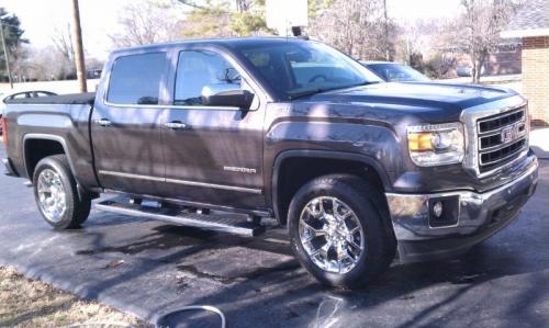

Found a few pics of my last few GM trucks. i could not find my older ones.  2009 White SLT 5.3 traded it with 90k miles it  was a notorious oil burner 2014 Grey SLT 5.3 traded it with around 50k miles on odometer it was a good truck no issues. 2016 Red Denali sold it with around 25k on odometer it was a good trouble free truck this one got me hooked on the 6.2 engine. 2017 Blue Denali 6.2 traded it with around 20k on odometer had the HPFP issue. 2018 Black Denali 6.2 currently around 6k miles and planning on keeping this one at least until they work all the bugs out on the new model style. I MIGHT be a GM truck person not sure yet.......
post-127028-0-24690100-1395103401_thumb.jpgpost-127028-0-21756000-1483288873_thumb.jpgpost-127028-0-54964500-1477964950_thumb.jpgpost-127028-0-23497600-1496015536_thumb.jpgIMG_6108.jpg.e290be35cc68cece468dee2ab8998786.jpg

Holy crap! Well at least you try a different color each time. :lol:

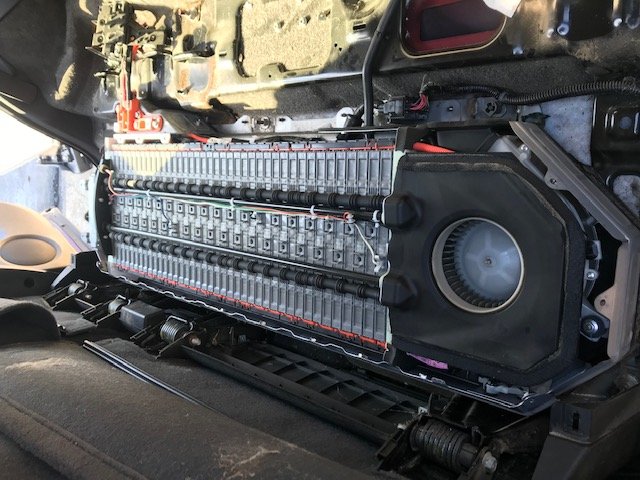

Does that battery pack give off much heat?  I can see the small fan it looks like. They are individual cells right?
No heat externally of the casing, the variable speed fan forces air from inside the vehicle through the 200 or so individual battery cells inside the casing and exhausts it under the truck to the outside. They say that if the interior of the vehicle is comfortable for you then the battery is comfortable LOL. The reason that I took it apart was to check the fan inlet screen. The intake screen was partially blocked with lint as you can see in the pics. The exhaust is the black plastic duct in the 2nd pic. My other airflow issue was the weathetech floor liners. The lip that turns up was actually blocking airflow through the slots where it is supposed to draw air from at the bottom of the seat area. A good pair of snips and some trimming took care of that in short order. Purring like a kitten now.........................and I hope it continues "knock on wood"

That was smart for taking the time and effort looking at it and finding the the lint blocking the vents. Interesting no cabin type filter for it. I am fascinated at the tech and engineering I am seeing. Thanks for sharing these pictures. I want one just for the tech it has though I am out of parking spaces now. Hmmm. Maybe now that this tech is more readily available (cheaper) GM will try again for a large hybrid. I would be a buyer at a reasonable premium with a sufficient warranty. What were all the original warranties?
