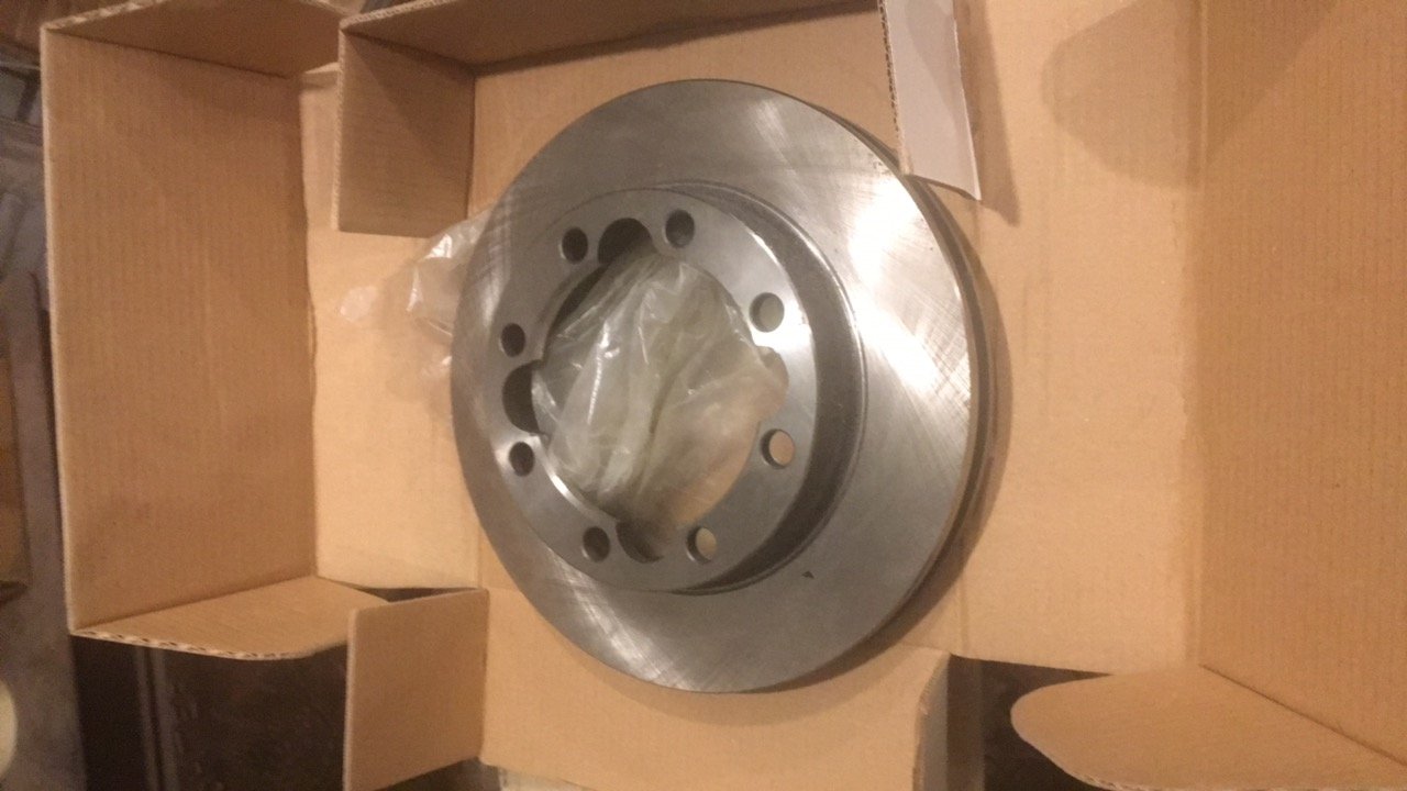

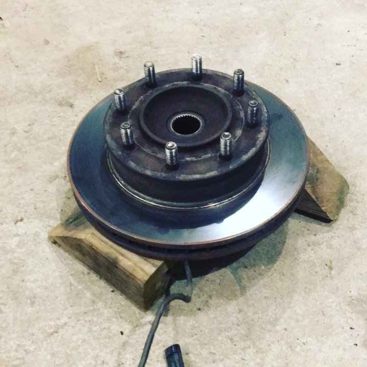

Okay guys, I believe I figured the issue out last night. ? My new rotor on the passenger side was warping. So when the truck sat at Merchants to get aligned it was cold. We drove it in, lifted it, no issues.....wheels spin free. Well after driving last night I pulled it in the shop and lifted the passenger side and it was rock solid. I was able to get it free but only about a quarter turn back and forth. 10 minutes later after it was free again, but now I could see where the issue was. The rotor was only showing itself after being hot. I threw a new rotor on last night. Looks and feels great. We will see today when I drive to ball practice. ??
Okay guys, I believe I figured the issue out last night. [emoji120] My new rotor on the passenger side was warping. So when the truck sat at Merchants to get aligned it was cold. We drove it in, lifted it, no issues.....wheels spin free. Well after driving last night I pulled it in the shop and lifted the passenger side and it was rock solid. I was able to get it free but only about a quarter turn back and forth. 10 minutes later after it was free again, but now I could see where the issue was. The rotor was only showing itself after being hot. I threw a new rotor on last night. Looks and feels great. We will see today when I drive to ball practice. ??
Sounds like a seized caliper to me...
I thought the same thing last night but I was able to run the caliper in and out freely and the line wasn't collapsing. The rotor is definitely out of shape using a straight edge and spinning it. The plus side is that both are less than a month old so their under warranty if I find the caliper to have any issues. ?
