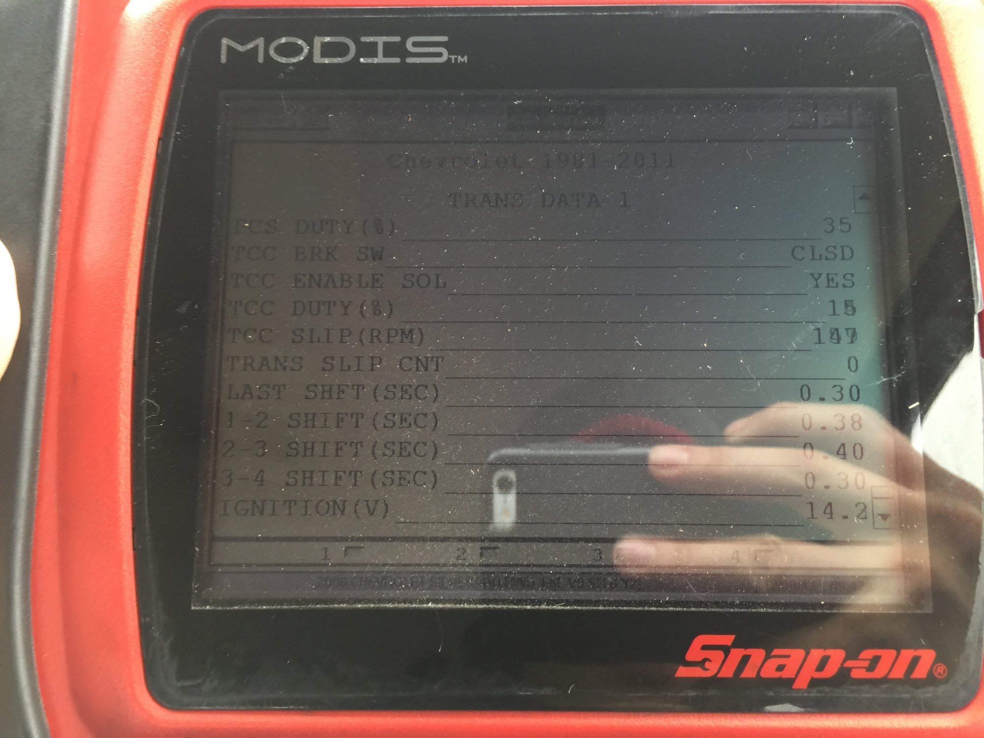

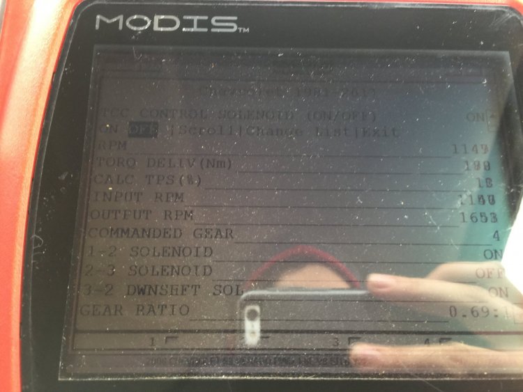

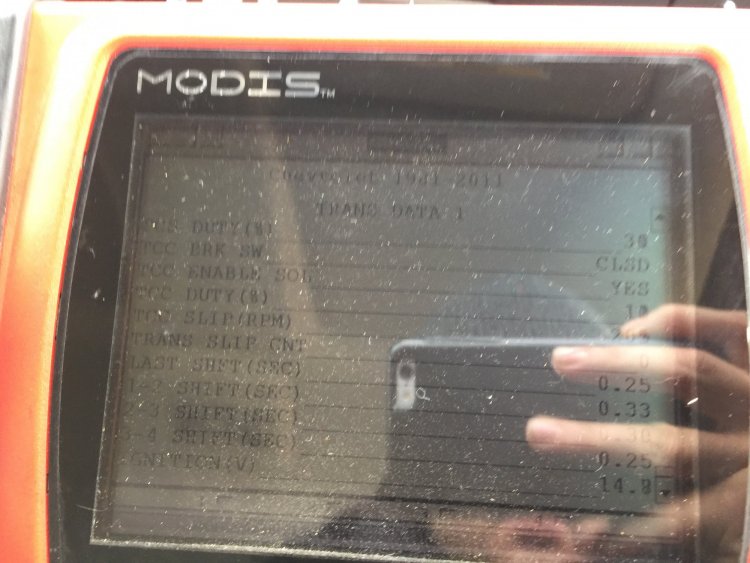

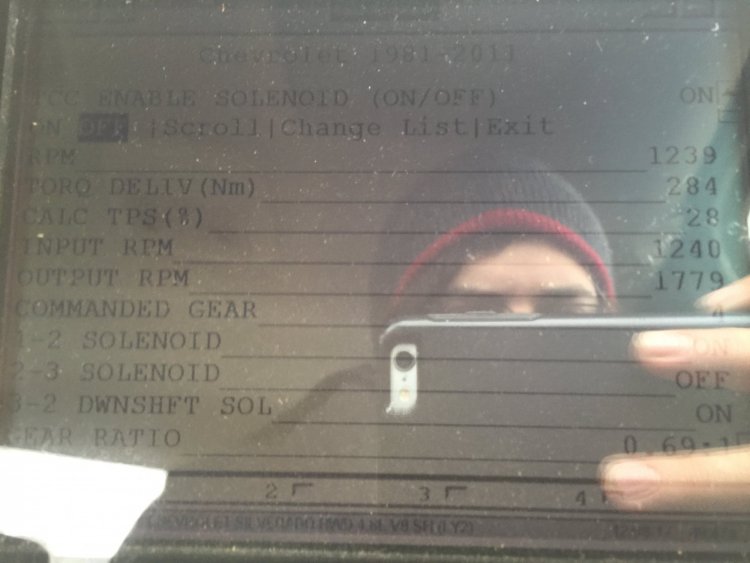

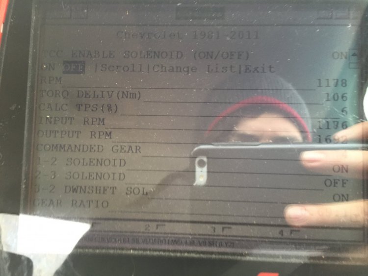

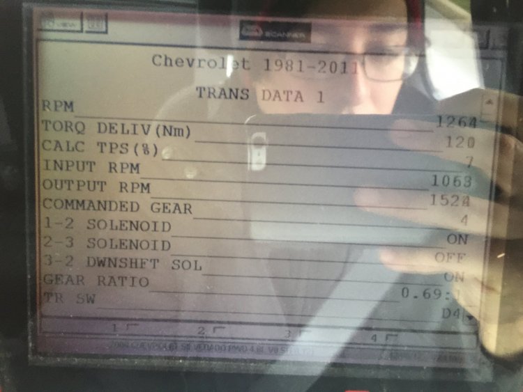

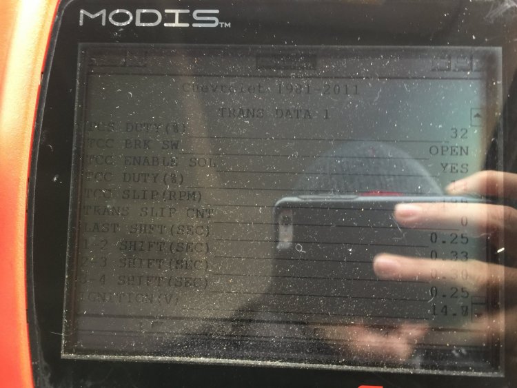

I just got the truck a little over a month ago. It has progressively gotten worse. Big kicker here it was flood damaged. I have replaced BCM that was bad, drained and changed all fluids. I took some pics of scan tool screen. I’ll post in a few.
So in two pictures you can see the data screen where it says “TCC ENABLE” it says “yes” well it says that even if the brake is slightly pushed and continues to bounce in and out of lockup.

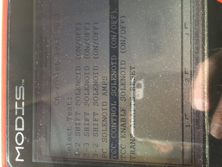

On other pictures you can see I lock up the TCC manually and it locks up perfect. Any help deciding this data would be much appreciated. By the way. The brake does cancel cruise control
What size tire is on it and when it is happening what does the engine load read on your scan tool?
It uses MAF signal intake, vehicle speed, vehicle RPM.
That's why when you go up a hill or slight incline, your vehicle will drop out of TCC.
I believe you need to find out why your engine load is so high. Really need to get an engine load chart per Speed/RPM
If the vehicle thinks it is struggling it will pop in an out of TCC.
