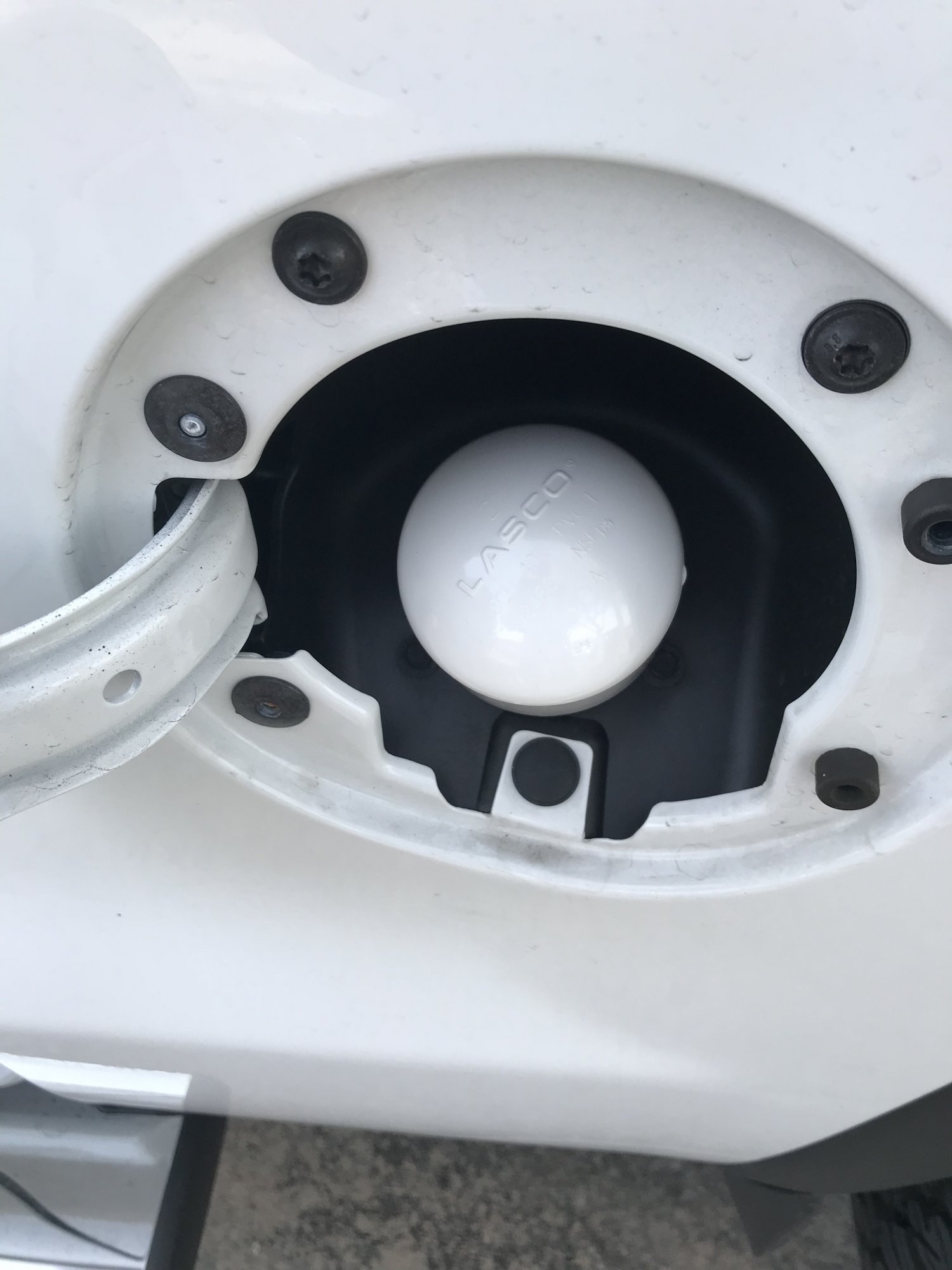

The capless fuel filler is not a very impressive idea. On my 2018 Sierra 1500 I have had to carefully sweep out snow from the flap before I can fill up several times this winter. I live in eastern Iowa and we have had a lot of snow this winter. Very disappointing to open up the fuel door and there is snow inside and on top of the "Protective" flap. Obviously GM realized it was a problem as the new 2019's at my dealer have a rectangular door with a rubber seal all the way around. Thanks to all for the helpful suggestions for possible types of caps to use.
There is an easy solution to keeping water and dirt off/out of your flapper filler...$1.98 at Lowe’s...it’s a LASCO PVC end cap, fits perfectly and doesn’t interfere with the door closing. Here is mine (white) and one I did for a friend (black). I just shot some gloss black spray paint on his.
