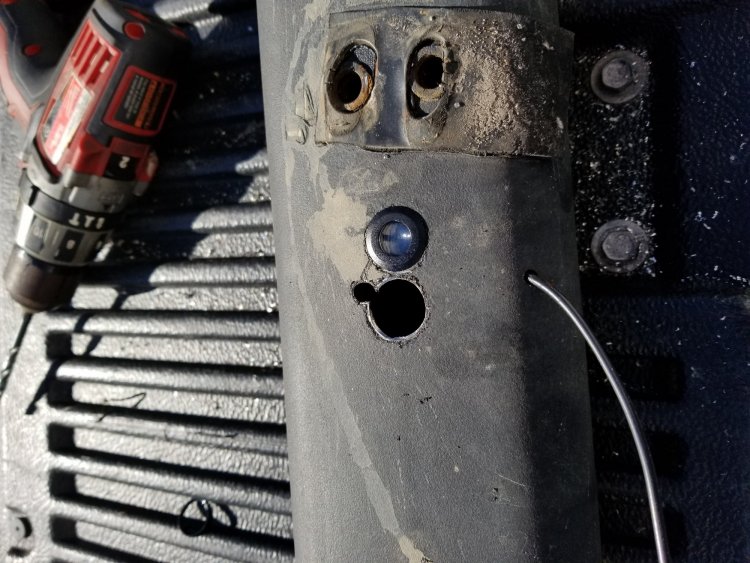

Put one on each side of the truck wired to reverse lights. Light always comes on in reverse day or night and then when the unlock button is pressed and it's dark enough outside. Flush mounted underneath the step. I drilled two holes, one to mount the light in and then 1 so i could get the wire where i needed it and to put my finger in to tighten the retaining nut. I think for 17 bucks they look darn good. I have other pics but it's hard to post multiples due to file size on my phone.
Pic of the holes needed. The small hole next to the big hole was what I needed to allow the nut to fit inside the step

Its not the same one but they are all about the same. The supplied hole saw will not cut stainless steel which is what my steps were made of. it ate the teeth off right away. I ran up to lowes and bought a lenox one for 10 bucks

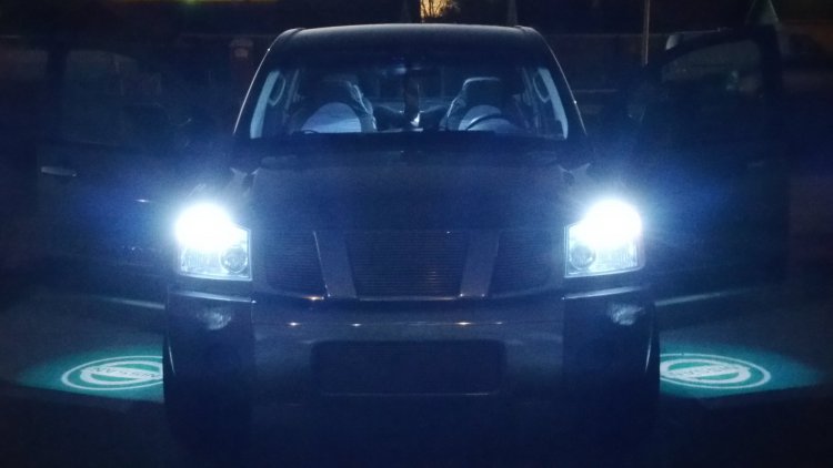

Nice! But, they look pretty close to the road. It might be fine for folks in the southern states, but I have to wonder how they'd survive the snow and salt in the northeast.
I had the Nissan ones installed in the bottom of the doors (factory location) on my Titan. I was thinking of putting them on my Silverado, but I never thought of putting them in the frame like that. Wonder how well they'll hold up over time there being exposed 100% of the time.
They need to make one that is a direct plug in replacement for the LED puddle lights under the mirrors.
They are a little behind the bracket on the steps so not much should actually hit them. Obviously they're up inside the step as well so as long as the lens doesn't get hit I think they'd be ok.
Only the lens is exposed, the rest is up inside the step. It would be a fairly quick change if they break.
