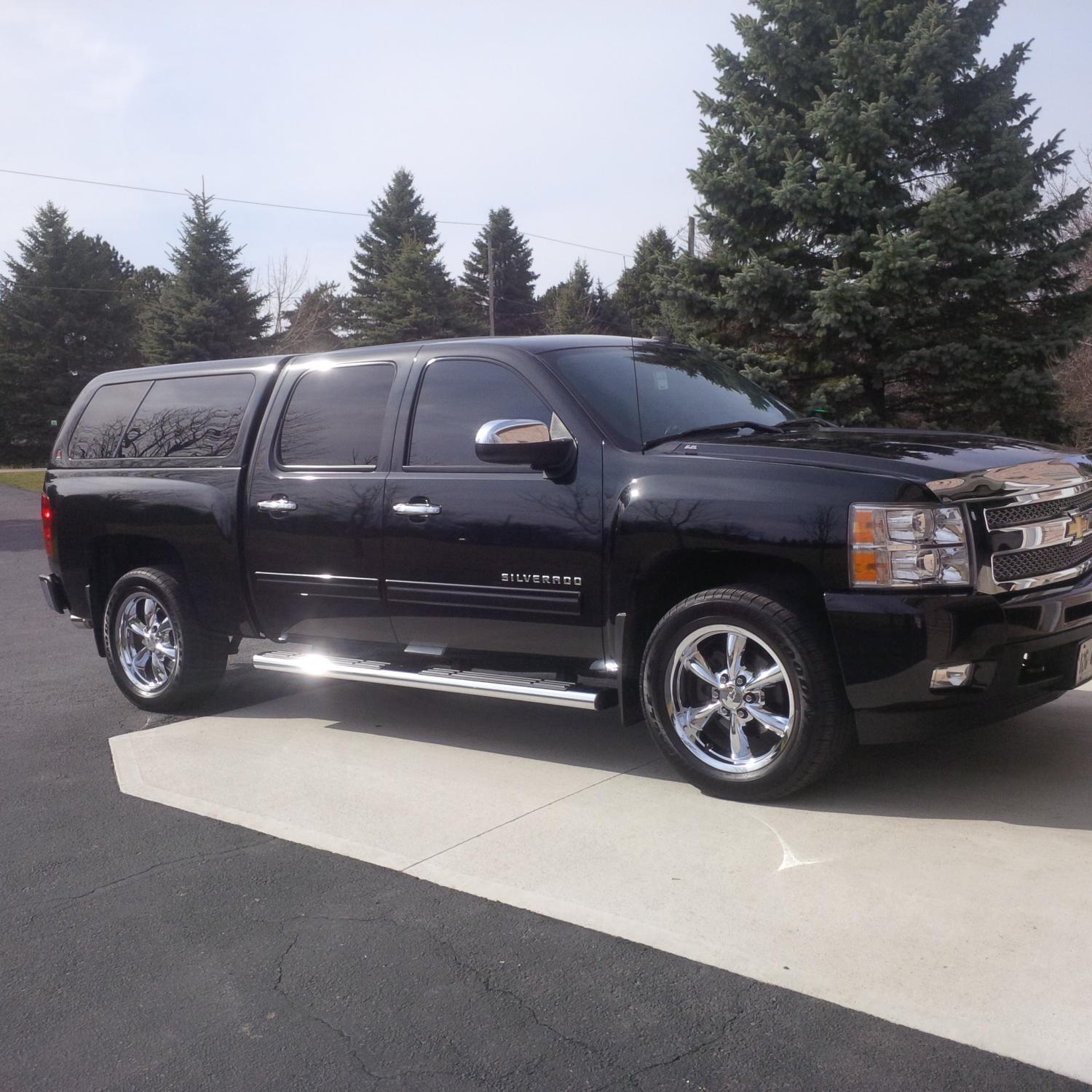

I know this is the wrong place for this topic, but here there is a lot more traffic. I need opinion on a staggered tire setup I'm hoping to run on my truck. I finally need new rubber and I was hoping to run 305/50/20 on the rear and the stock size of 275/55/20 on the front.  There pretty much the same diameter. 31.9" vs 32" tall.  What does everyone think of this setup? Good or bad?? Trucks a 2010 silverado 4x4 with auto 4wd option.   Rims are 20 x 8.5". This is strictly a summer setup which the truck is in 2wd mainly unless it's raining.  My concern if any would be transfer case.  post-87526-0-50336700-1491225125_thumb.jpg

I agree I won't be able to rotate the tires the way I should, but I like the look of the wider tire out back to fill out the wheel well.  The 275 up front still allows me to turn without rubbing.  My main concern is the transfer case, is the small difference in tire height going to do any damage?

From my experience your front to back tire diameter difference of .1” (31.9” to 32”) shouldn’t cause any problems with the transfer case.  Usually if you get closer to wheel tire combos that are .30”-.50”+ difference front to back then you’ll start to see problems with traction control systems acting up thinking there’s wheel spin due to the varied wheel rotation speed from the different diameters. But your .1” difference shouldn’t be a problem, the closer in tire diameter front to back the better, same diameter being best.
FWIW I had a staggered wheel tire set up on my previous TBSS that was AWD all the time and in 100K+ miles never had any transfer case issues and although I was not able to properly rotate my tires I would average 70K miles on my rears and 45K miles on my fronts. That was mostly highway miles, driving more city than highway will reduce that tire life without ability to rotate.
The guys in the thread posting comments about “jacking up the rear” and “popular look back in the day” are thoroughly confusing tire width versus tire diameter. It is very possible and quite common to install a wider rear tire offering more traction for RWD applications without changing the tire diameter or vehicle height at all from front to rear.
My only question would by why install a staggered summer tire set up on the same size 20” x 8.5” rims front/rear?  You’re going to end up with significant tire bulge in the rear and a more square tire sidewall in the front.  If it were me I’d pick a different style rim that offered a staggered width to match the tire,  you’re 275/305 tires should be on a 20” x 8.5”/9” front and 20” x 10”/11” rear.

Well after lots of Internet searching and helpful opinions on here. Looks like I will go with 4 tires the same mainly due to the fact I can rotate them from time to time. Even though the staggered setup would look cool. But not practical on my daily driver.   So now I'm back to my  original thought of.   275' 55s all around or 305 50 's.   Thanks for steering me into the clear everyone. I'll post pics when I finally make up my mind and get them installed.
