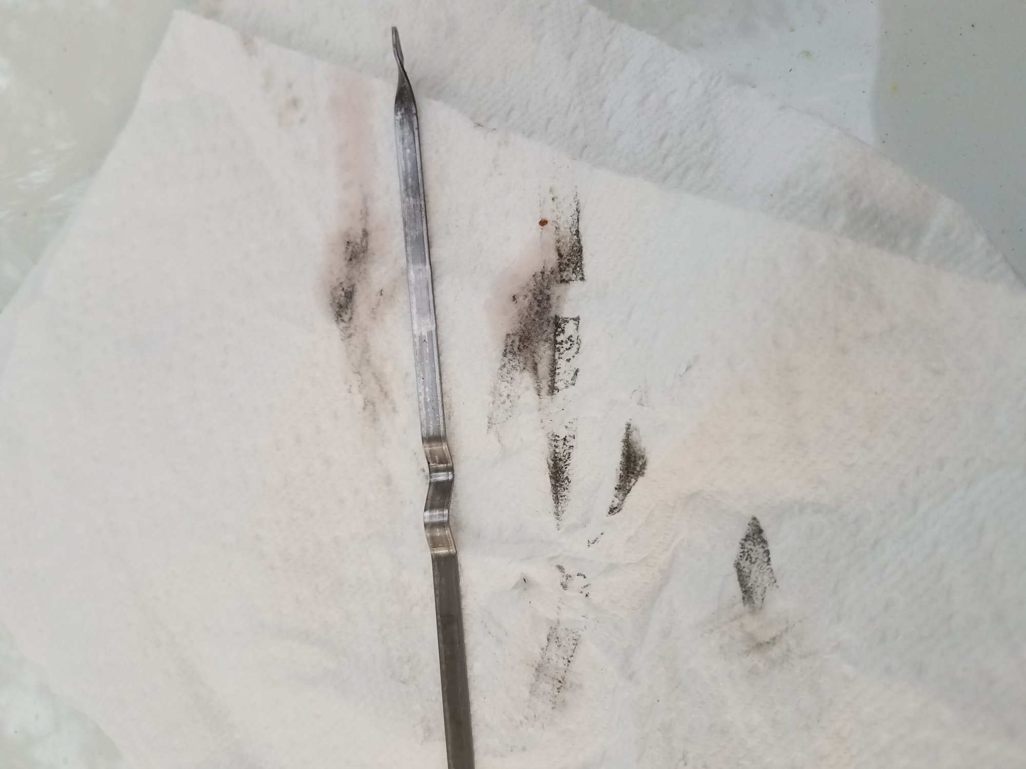

     My 2017 1500 5.3 shifts much better after the 3 firmware updates, not sure which one it was as it dosen't show on the repair order. I still have a very hard downshift from 3-2 and 2-1 not all the time but when it does it its very obvious and annoying. Coming to a stop or exiting the highway on the ramp.  I'm sure as it continues It will get worse as the specs increase from the wear. I pulled the dipstick today just to see if the fluid was still good and when I cleaned the stick it had alot of what appears to be metal or friction disk material. Is this normal? Attached pic. I have also noticed that after the temp goes past 160 or so that's when its more consistant with the hard downshifting.I was curious if anyone having this issue has tried full syn or those high end multi application fluid?  My normal op temp is around 190 and I dont think thats too hot to cause issue. Seems like the computer is just mis-calcuating the speed during downshift,
Sorry if this has been covered already, I love the truck excluding the wierd transmission. Forgot to mention its a 6 speed and I have 1,933 miles on it.

Search on this forum for hard downshifting and odds are you'll find a few of my posts.  I have a 2016 5.3 6 speed (bought it new and currently have 19k miles).  I had it in several times for the downshift concern and sadly there is no fix.  I've had it drilled into my head that it's a characteristic of the transmission.  I even had the valve body with TCM replaced a few weeks ago, this did not fix it.  Sadly, the issue is in the programming  and GM will do nothing anymore with the 6 speeds.  Love the truck, just hate the downshifts when coming to a stop.  In town driving is stupid, on highway its awesome.  BTW I see you are in Tampa.  I love Florida!!!  Fargo, ND here.
