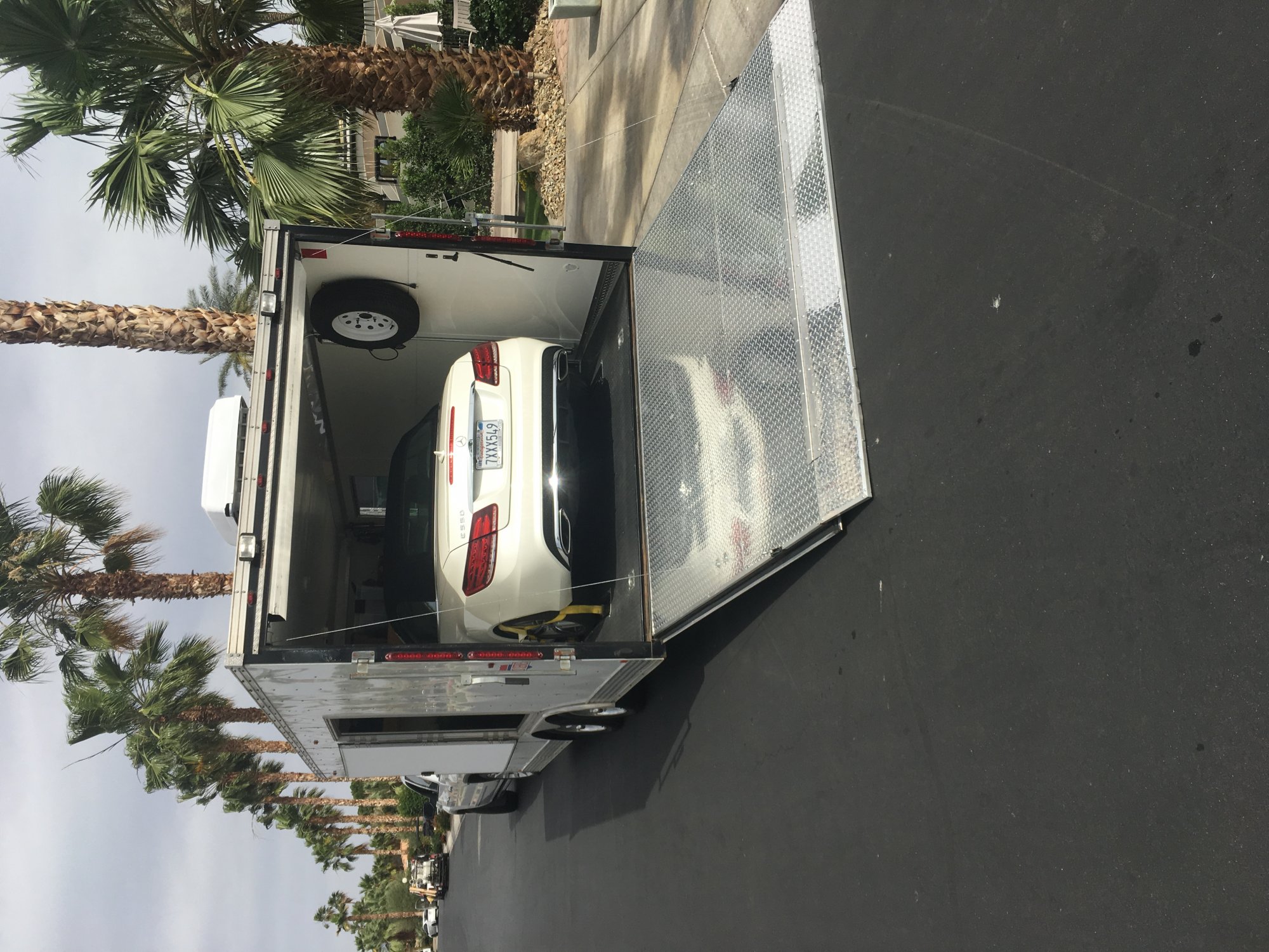

Yes I know I’m over the 7200 truck limit some. The trailer axle weight was 8500 so total is 15,700. Assuming a truck weight of 6000 and a trailer weight of 9800 means I have 1300 lbs tongue weight. I have a weight distribution hitch so the truck sat level. Do you all know that the hitch is only rated at 5000 without a weight dist hitch?36CDD8F4-6A36-4502-926E-67F33965C697.thumb.jpeg.4924cad5c57a0739474dd3a6796f20af.jpeg

Yes, standard class III. You can upgrade to a class IV or V if you want more capacity.

That's a nice trailer!  Any details on it you can share?  I'm in the market for similar in the next year or so.
On the hitch, that's not quite correct.  The hitch is rated to 12,000 lbs without weight distribution, it's the truck that isn't.
