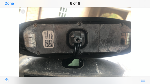

My 2017 Silverado 1500 has been doing roughly the same thing for the last three or four months I have took my truck to the dealer had the radio replaced along with the screen also had a hard restart done to the electrical system and I still have the same problem. Just took it to another Chevy dealer and they found that my shark fin was malfunctioning causing my GPS to not work with OnStar along with the fact my HMI unit needed an upgrade. The HMI unit had not been upgraded since the day it was put into the truck from 2016. So almost guarantee you need to have an HMI upgrade and maybe the Shark Fin replaced to fix your truck. Mine has now been working great for a week since I got my HMI update and the Shark Fin replaced.
