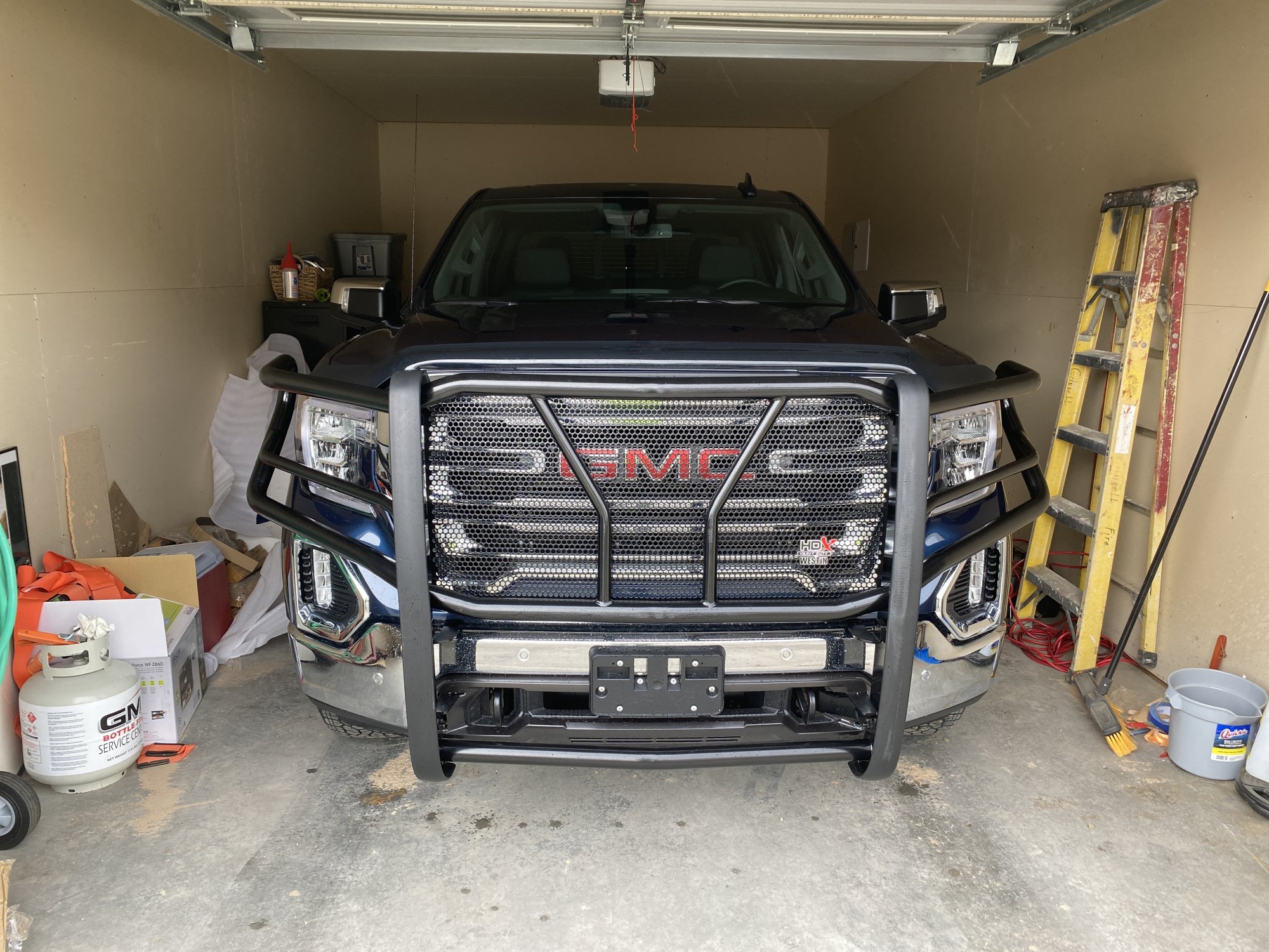

Ok. So I can confirm it does interfere with the front parking sensors. All 4 of them. There is the parking assist switch which turns it off. The dealer screwed up and cut the plastic in the wrong place for the mounting brackets. That part is on backorder so I have until then to decide if I want a grill guard or front parking assist.
I back my truck in most places so front parking sensors aren’t really a big deal for me. The rear still work fine and instrument panel tells you which sensors are going off so all intents and purposes I think I’ll keep the grill guard. Having that protection on Montana interstates is more important than front parking assist.
Does not affect adaptive cruise, pre collision, or lane departure. That is controlled by the camera in the rear view mirror assembly.

Also I believe there is a relocation kit for those sensors, I will look into that and report back with my findings.

I found this, I emailed Westin to see if this corrects all 4 or just the center ones. As soon as I get a response I’ll holler.
Oh, and the mounting brackets mount opposite of the recovery hooks! So you don’t lose those, I though for sure they would use the same spot but Westin nailed it on that one(minus cutting the plastic) lol

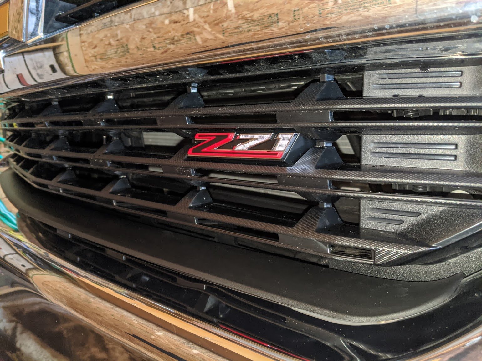

Finally installed the Z71 grille badge that I have had for months and no you don't have to remove the grille to install!
