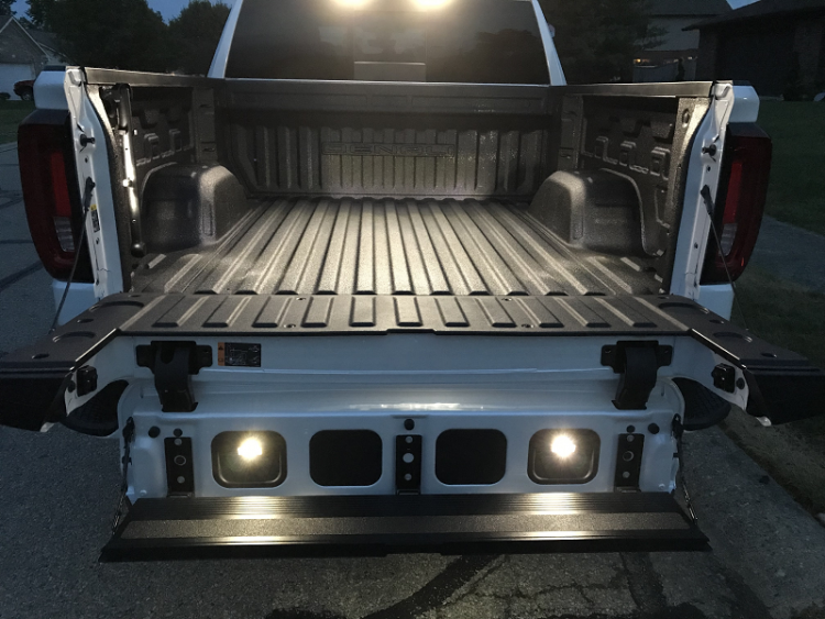

Nothing major.  Installed the MultiPro tailgate step light kit (P/N 84347814) earlier this week.  The install was super easy more or less plug & play.  Hardest part was getting the harness connector off of the trailer hitch light.  Connectors tend to not like me and want to either break or not release whenever I touch them.  This one was no different - have to really pull hard once you slide the red tab open.  Got this kit off of a seller on eBay & saved about $25 compared to the usual web vendors plus seller included instructions which were not included in the kit (have to access online service guide of some sort).  Thanks to member JacobC1983 for answering my questions via PM so I'd know what to expect in advance.
The light kit includes 2 LED light assemblies, 1 harness with 4 connectors ready to go with looming & electrical tape where applicable and 4-6 zip ties to help with loose connectors rattling.  I will attach the 4 page installation instructions below in PDF format.  In summary, the installation requires you to use a plastic trim tool to pry off the 4 plastic weld hole covers which are held in with plastic tabs on the pieces themselves.  Once those are off, look in the 2nd opening from the right and you should see the backside of the trailer hitch light.  The connector you want to remove is plugged into this light and has a red slider on it that you will want to slide down to release the tab.  Now pull the connector off.  Expect it to take a bit of effort for it to finally come off.  I don't recommend using metal tools if you want to keep things from breaking.  I found it best to grab the area closest to where the wires went into the connector and press down very hard with both index fingers on the ledge (you'll see what I mean if you see this connector).  Take care not to damage any other connectors nearby - maybe try to push them aside.  Once the connector is off, take the harness supplied with the light kit and plug the connector you just disconnected into the only female connector on the harness.  Plug the connector on that same end into the trailer hitch light (where you disconnected the first one).  Run the remaining connectors to the light assemblies and plug them in.  Before pushing the light assemblies in it's obviously a good time to set everything down on the step and see if things work.  These are controlled with the cargo light button in the cab.  If all works, use the zip ties how you see fit & pop the plastic pieces back into the weld holes.  IIRC, the lights are made to go in top first, then press in on the bottoms (if you have the tailgate fully open as shown in my pic below).  Lights can be put in any of the holes - provided harness had plenty of length if you connected the shorter wire to the right-most light.
Grabbed a pic just before dark to show how it looks when turned on.
