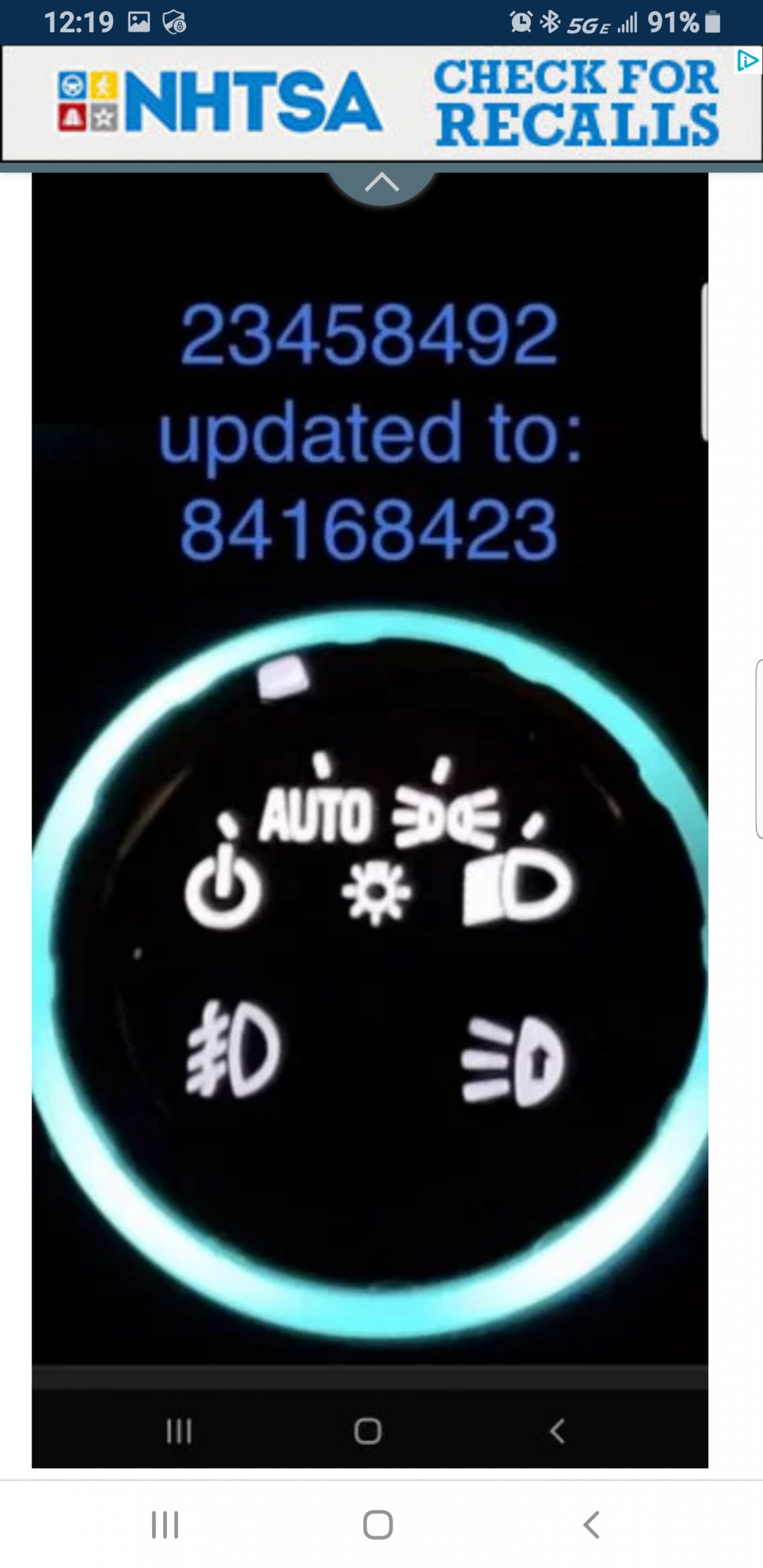

I tried to buy the switch (84168423) off gm parts direct and was informed they are backordered with no known lead time. Anyone know of any other sources?hopefully with free shipping

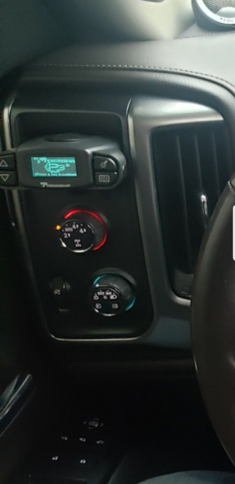

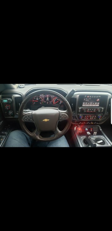

This is my dash now that I did the Denali cluster and all red controls. But I just need the red ORL switch now.

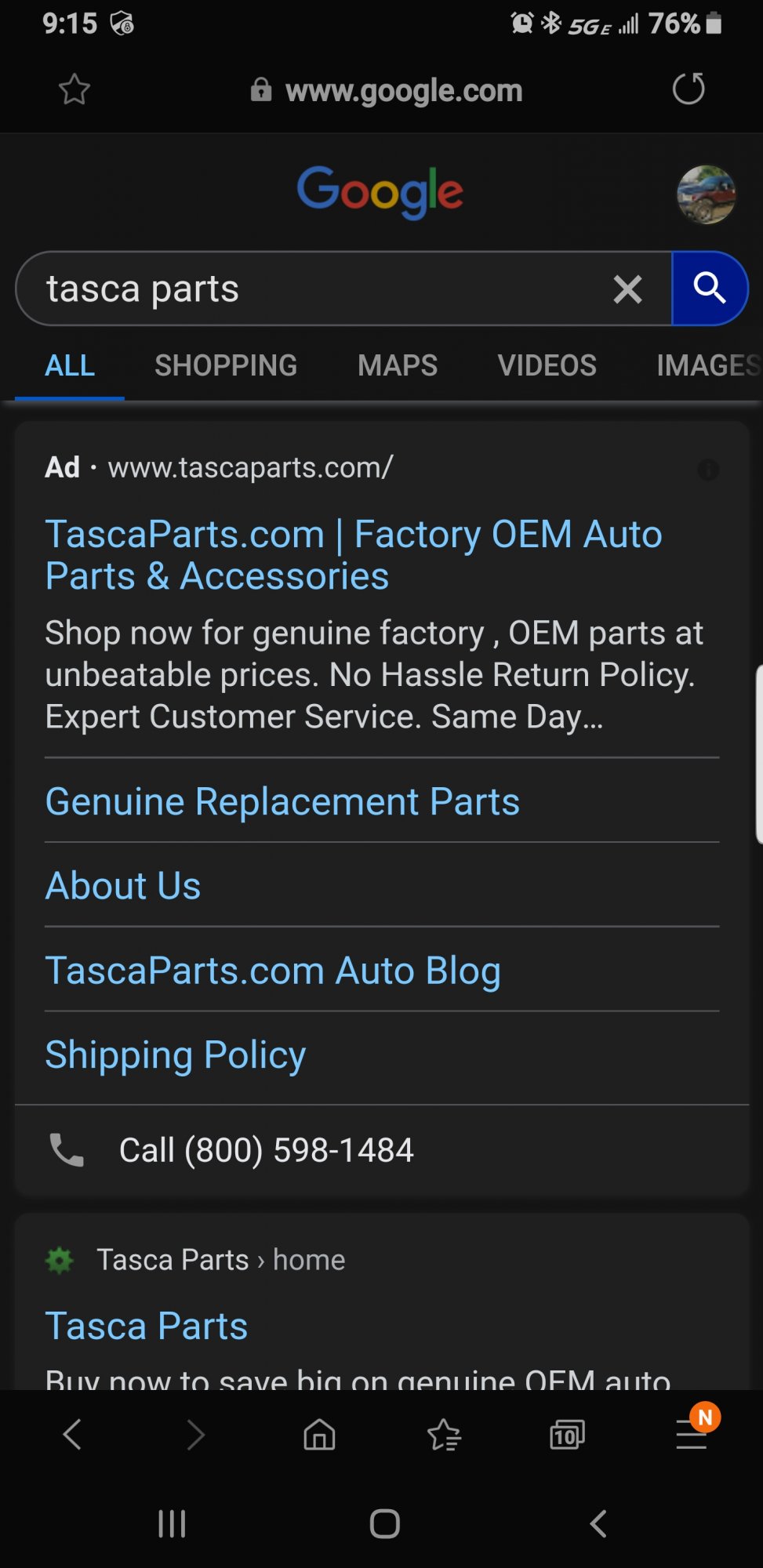

I ordered one from Tasca parts.  After taking my money, they informed me that it is a special order item, that will ship to me 7 days or so, after they receive it. I found one on Ebay for $20 more. It has already shipped,  and is almost to me. As soon as I get it in, I'm considering trying to get a refund from Tasca. If  I cant, I'll have one for sale, if it ever gets here

I guess I'm just used to Amazon,  Ebay,  etc. If someone has something for sale listed on a website,  I'd like them to actually have it. If you have to order it to fill my order, that takes forever.  I could have gone to my dealer for that. Maybe I'm just impatient.  I get that way, when I start a project.  Anyway,  I will most likely have an extra blue one, when it gets here.
Thanks. I probably will, after my Ebay one gets here, today. I want to make sure this one is what it's supposed to be.  No picture on this one. Another reason I ordered from Tasca to begin with.
