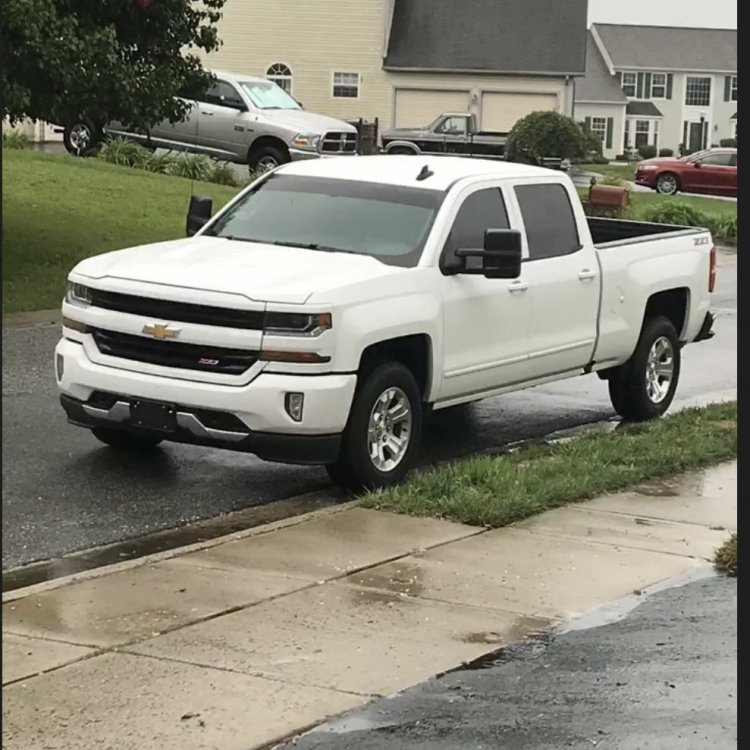

My truck came with 20s, and I considered switching to 18s for a few reasons.
1.  Cheaper tires
2.  Smoother ride
3.  I tend to prefer the appearance of a taller sidewall
4.  Lower chance of curb / rock rash on the wheel
But, I'm going to be keeping the 20s.
My tires are brand new, so I have a long time to save for replacements.
The truck rides smooth enough for me.
The 20s do look pretty good, and give the truck a more premium look.
I likely won't be doing serious off roading with this truck.
