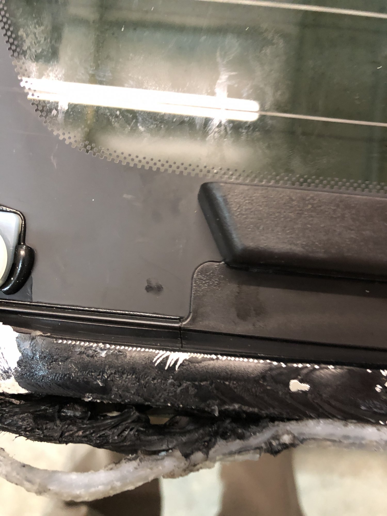

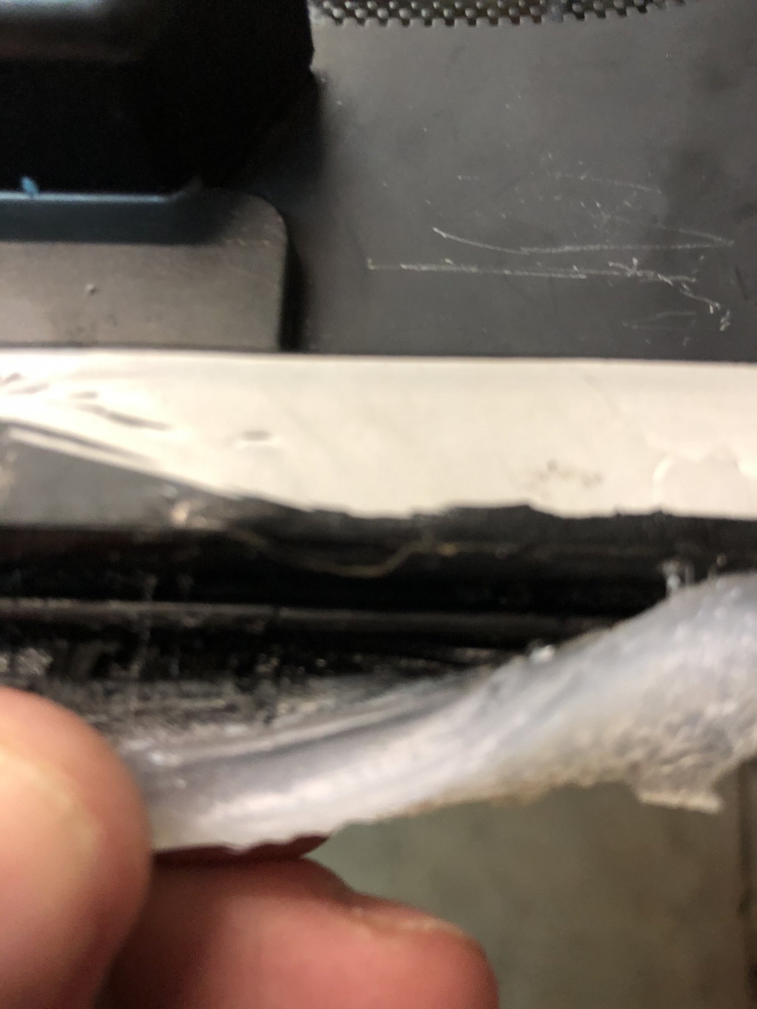

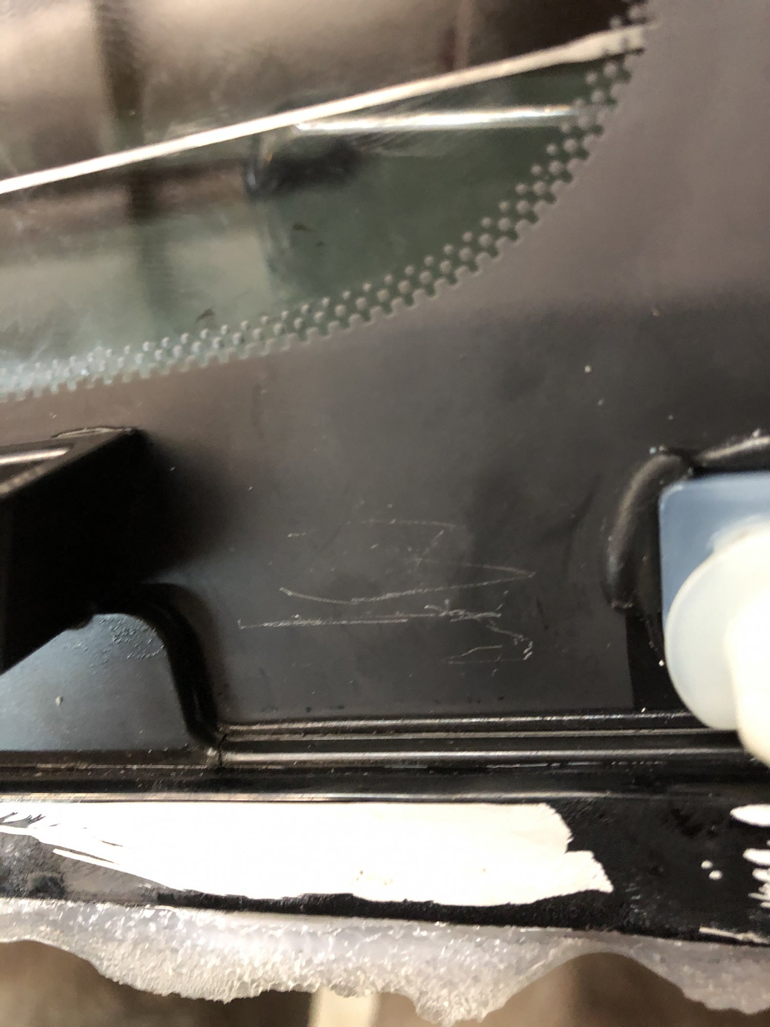

Cracked in the same place on both sides. I don’t know how the dealership didn’t see it when they did the first caulking job. I’ve got some other pictures of rust in. The truck I’ll try to post up tonight.
