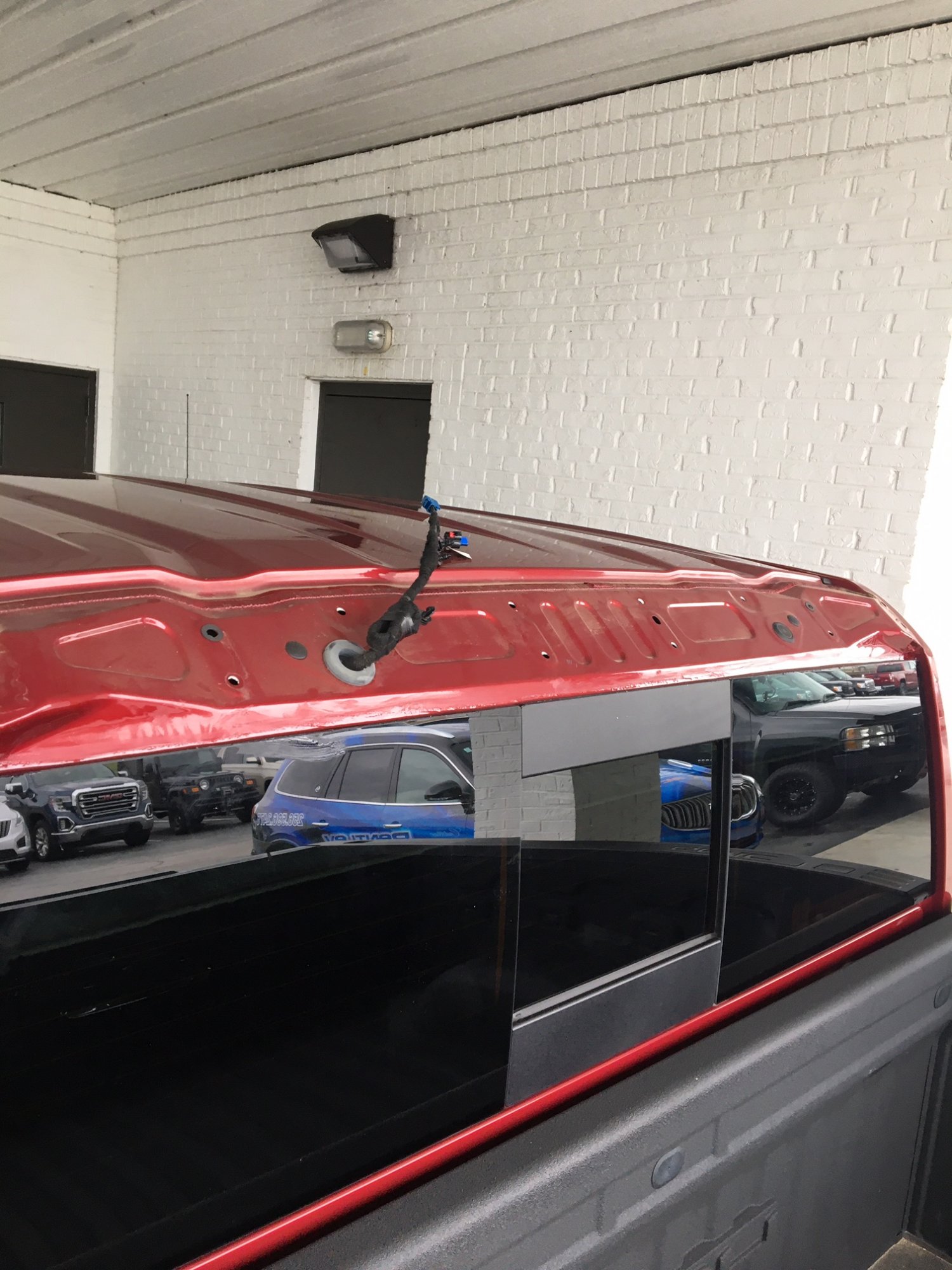

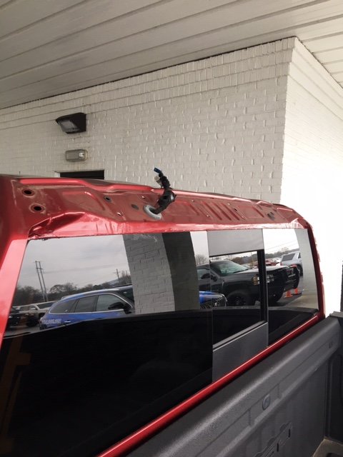

I was out this morning and close to the dealership so I decided to stop in and see if there are any updates. My truck has been in the shop since last Thursday for a leak after the second window install. Did not find out much other then they cannot find where the leak is coming from. I suggested they check the rear window. Anyway, all was not lost, I did snag a loaner while I was there.
Also while there I did notice several Sierras in the shop and I spotted this truck outside. It did have the chalking job done to it. At least it was under cover. This is not my truck. Thought you guys may enjoy the picture.
Great pic, could you upload the full size image? You can totally see all the design flaws in this, just crazy.

Why do you think this spoiler was added to the roof design starting in 2019?
A.) For appearance?
B.) For fuel economy maybe with slightly improved aerodynamics?
When you look at that picture of the red truck with the spoiler removed, how in the world can that stay sealed for years to come.
Every hole in that roof has the potential to leak into the truck due to poorly sealed spoiler.
So many contours and surfaces have to mate perfectly.
IMO...They made a mistake with this spoiler.
