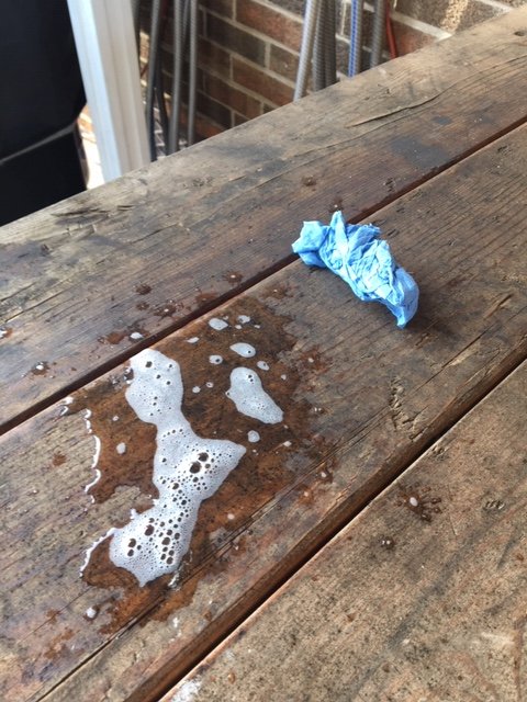

Another update! While I do like my dealership and the service manager my confidnce with them is starting to plummet. Picked up my truck Friday afternoon. Not feeling real confident because nothing was done to fix the issue. We had some nice weather yesterday and my truck was dirty from sitting at the dealership so I decided to give it a wash. You guessed it,  just an easy hand wash with a normal water hose, not more water on the  window or no less. And I have a leaking rear window. I stuffed a blue heavy duty paper towel into the sliding window track, this is the area I found water last time and told the dealership that. After washing a drying the truck I checked the paper towel and it was soaked. By looking at those pictures of the soaked paper towel, can you imagine how much water would enter the cab if the truck was sitting the the rain for a few days. Back to the shop tomorrow. I am quickly moving toward the Alabama Lemon Law requirements.

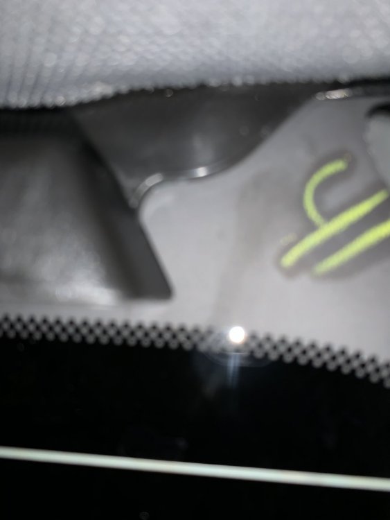

I agree, the fundamental issue is the overall design. I took our dogs for a walk last night and looked at every single rear window on the vehicles on our street and they are all flush mount. The giant gap at the top of the window with just seam sealer over it with a spoiler dripping down on it is just absurd. Any small void in the sealer introduces a leak and we all know water can find its way into any little space.

A simple redesign of the spoiler would eliminate water getting into the cab completely as long as the spoiler bolts are sealed up broken plastic frame or not.  I have pictures of mine that have been sealed and I can assure you the spoiler won’t leak through a bolt hole.
I don't understand. If you are assaying the spoiler is the issue (at least most of the time) while does this issue seem to occurring only on trucks with the sliding rear window. What is different on these trucks other than the rear window?
I’m wondering if we can get someone to design a little bracket, something thicker than vinyl that would be able to go between the gap of the window and spoiler and direct water out. Something like the attached drawing.
You know that is logical. You wouldn't trim the outside windows of your house without a flashing. Why isn't there at least a drip edge on the spoiler?
