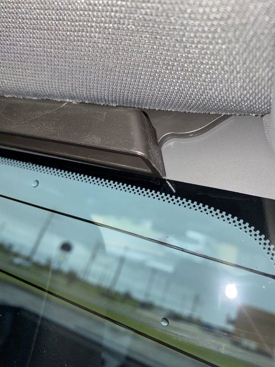

I think iv just found something.  My E9 window appears to have a different wider shape where the track ends.
this is my e9  Looks like the plastic goes outwardCB26A784-9F0C-4CA2-AB9B-6986D0E5EFFB.thumb.jpeg.caa92f4476148cb0ff28188d420a1a52.jpeg
Saw this picture of a cracked frame a couple pages back. Look where the track ends the plastic goes straight upD5CD3D3D-2F3A-4E72-AD51-775420CD9B54.jpeg.07b5037044913335cf9e1cd94229d5cf.jpeg

It was your picture I put in my post. But the actual plastic sliding frames in our windows are different
My E9 is the same wider and differently shaped design... maybe it is a fix to the frame? Just because the window is an E9 doesn’t mean the frame is the same.
