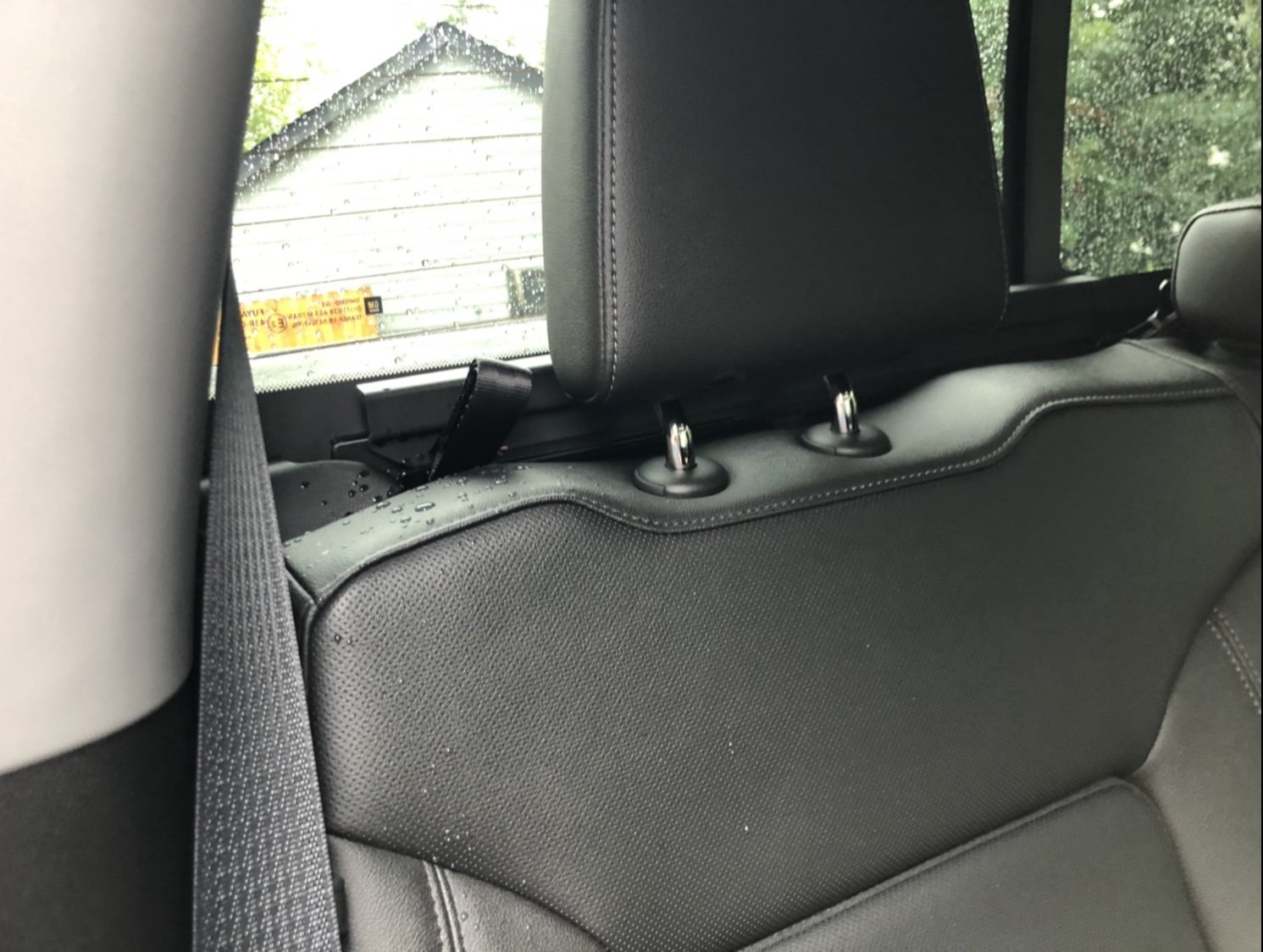

Well I think I jinxed myself. Just found water drops on the back seat again. It's not leaking bad but it is leaking from both sides. The headliner is not wet.

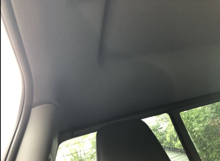

If you can push the headliner up in the corner inside truck look for a crack in the plastic like this. That is where mine was leaking in on both sides.. that photo is behind the rear driver side headrest then go straight up to where headliner meets rear window and Push it up.6ede42394478fa48dcdaf9e694d2c092.jpg
Sent from my Pixel 2 using Tapatalk
