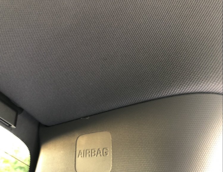

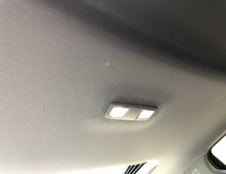

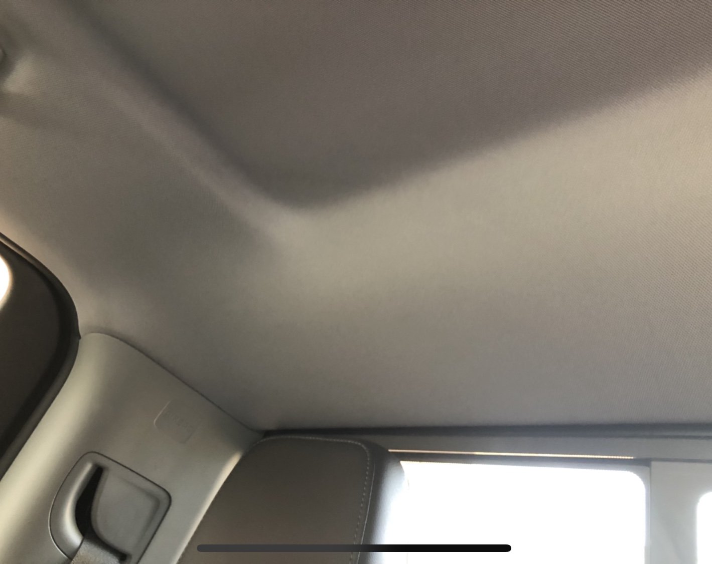

Well, I have it back temporarily and what a mess they made. I just feel sick about the whole thing.
Dirty fingerprint marks all over the thing. The stuff around the dome light is really disgusting. The also put pry marks in a couple pieces of trim, scratched up the windshield with the A pillar trim and broke my rear view mirror, which mysteriously now wiggles up and down about an inch. What the hell man. All of this and it might still leak, and you can still see the faint waterline where the window leaked onto it...going back next week and emailing these to their service manager.
Am I being unreasonable here? I mean I keep the thing in perfect condition and get it back like this...

I don’t feel you’re being unreasonable. You paid good money for a working & non-leaking truck with a limited warranty. They screwed shit up while working on it. On them to fix or replace it.
I’d try some Folex (Lowe’s) on the grease spots left on anything that’s fabric (test a small spot) if you have to do it yourself.

I don't think you're being unreasonable. You should never get your vehicle back in worse condition than you gave it to them.
I had a similar experience when my window was being fixed...they gouged/scratched the interior kick panel taking the back seats in and out. Had some  scratches around the back window where it was removed and found 2 screws rolling around the back seat.
Thankfully my dealer made it right.
