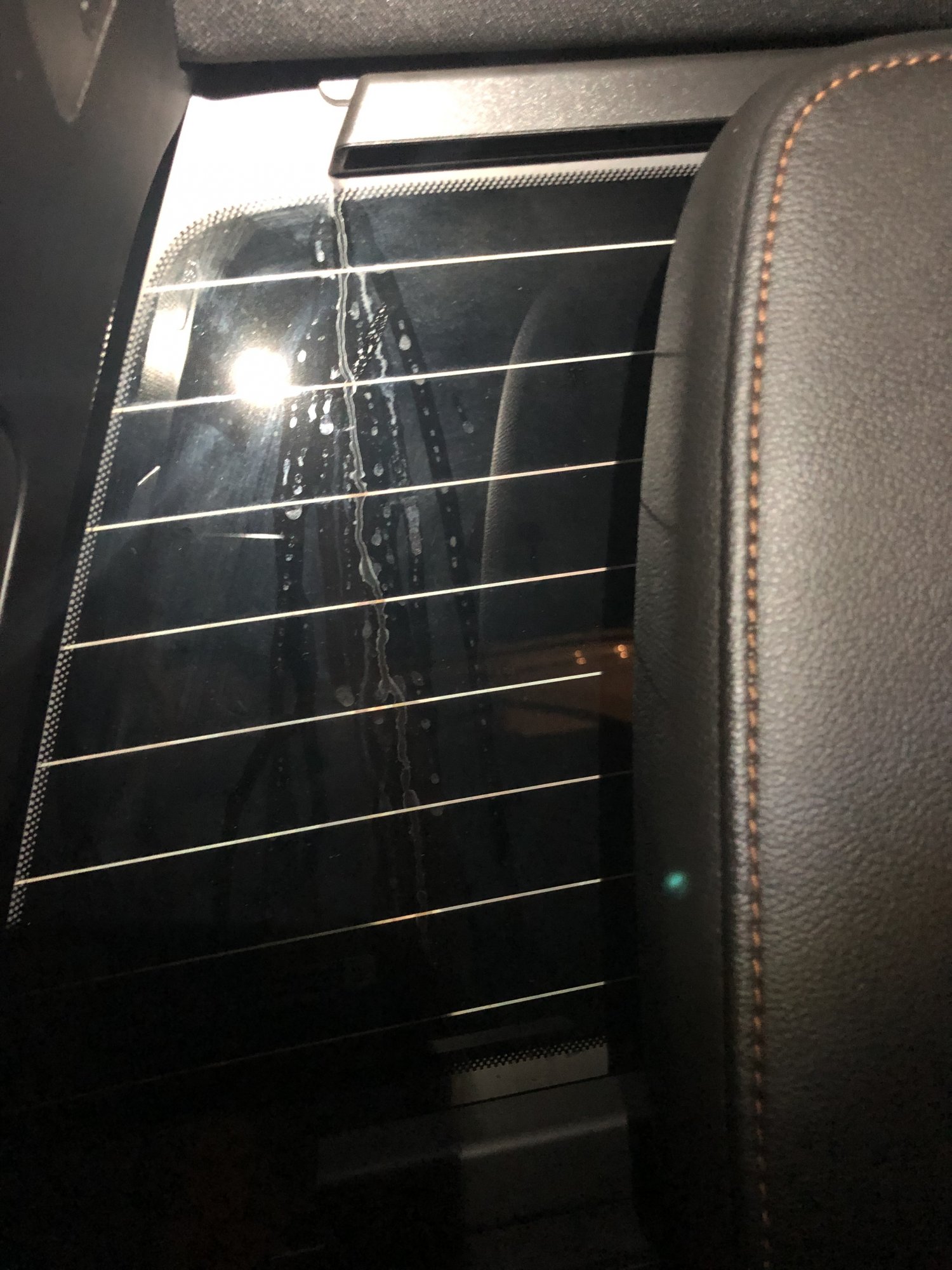

Posted earlier.  19- trailboss. Build date  2/19.  Window leaked two weeks ago bad on both sides.  Dealer sealed top and actually did a good job.  Well, today we got heavy rain and it still leaks and from what I’m told there is trucks with build dates past 11/18 that have seen this issue from GM using old stock windows.
Body shop guy actually tracked me down a new window within 20 minutes. He said one of only two left because of strike.  New window hopefully next week and no more water.   I also stressed before first repair and reminded him to tell glass guy that  I paid a lot of money for this truck and I would appreciate extra care to prevent scratches.  Good luck to you other guys.
Most of the damage to mine was them cutting through the heavy sealant on the outside to get the old window out. You are bound have better luck than I did.

My truck is build date 2/19.  The rear window has leaked and been re sealed at dealer.  So it leaks again.   But since my truck does not fall under bulletin for trucks 11/18 or earlier the fix per GM is S follows.
First, apply sealant around rear window, if it still leaks and cannot identify leak remove existing window and install same window with new sealant.  If it still leaks after some time  , install new glass.  I have gorilla tape on my rear spoiler and rear window  on my new truck window to prevent quite a bit of water coming through cab.

Did you try calling Safelite to see if an aftermarket rear window was available? When mine was leaking I had them keep it in their shop garage out of the rain for two weeks until it was fixed and they gave me a loaner.

Good luck to you with the sealant job.  I was hopeful it was gonna work for me , but no luck.  I taped my spoiler and window up with clear tape and somehow this weekend the water started dripping in on drivers side.  Back of my rear seat is soaked and musty,  I had towels to soak up the water but I took them out to dry over the weekend which was a mistake.  And dealer says they won’t give me a loaner and to just park it until my new glass comes in which could be weeks!!!  I spose I’ll just walk to work while my 55k dollar truck stays parked and dry.  Starting to get pissed about this also.

It has been 3 weeks since I've had the bulletin (seam sealer) fix which was the 1st repair attempt. Big rainstorm last Friday and the leak has returned :(
Dropped truck off Monday and dealership has leak tested and verified. Took some convincing and lengthy discussion with the service mgr however I do have a new rear window being installed as I type :)

While detailing my truck the other day, I was about to wipe the back windows and I saw the dreaded leak. Maybe not looking or thinking about it made it better. But now that I've seen it, I don't think I can un-see it! Based on the gooping effect, the breaking all kinds of parts while attempting a fix, the scratch everything issues... I'll say I'm quite afraid to bring this up to a dealer.
