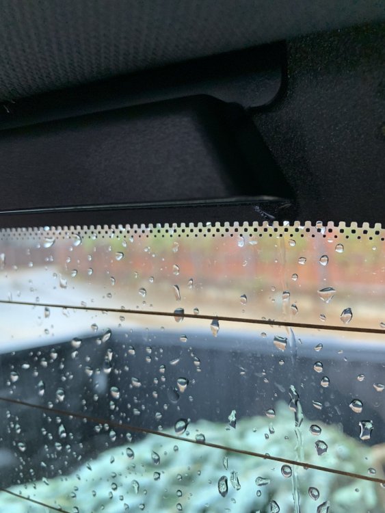

It’s been raining off and on for nearly the past 48 hours. My RST has been parked inclined on my driveway, with the bed lower than the hood.
Here’s where my water leak is coming from:
Very minimal trickle. I left a paper towel at the top of the seat to absorb any water over night and it was damp this AM. So I’m glad it’s not a terrible leak.
Going to try and get the truck in for a fix this week, but not sure if I’ll have time.
