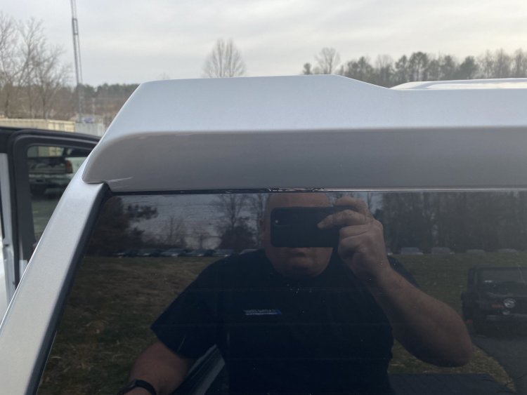

Two piece Spoiler/cab arrangement on the '19+ differ from the previous gen. The flexible plastic spoiler is attached to the cab by gasketed mounting holes and arrangement does have some flex as evidenced by popping noise due to expansion creep in the hot Sun.
Anybody consider that the leakage problem may be caused by brush free car washes? Could be that the cause is not the sealing of the window unit assembly but the seal between the plastic spoiler and mounting holes on the metal cab.
Seal might never leak under normal rain conditions or testing with water from a hose, but blasting with a narrow jet of 300 mph air into the micro space flexes the spoiler and compromises the seal and once the bond is broken it will continue to leak underneath the headliner and down the inside of the glass. I never use car washes and been through numerous thunderstorms and remains dry as a bone.
Update on my 2019: the dealer recognized that the crack in the upper window frame was an issue. They were able to get approval to replace it on the first go. Now they are waiting for an ETA on the glass since it is on back order.

I had to laugh at blaming the car washes for this. The bulk of these leaks aren’t from the spoiler, but cracks in the window frame. Those are the result of nothing more than poor design or a poor quality part. Mine was dry as a bone, until it wasn’t.

I’ve posted my story before, but my truck went through the auto-wash probably around 2 times a week for 6 months before the leak appeared during a slow, steady rainfall. The diagnosis was cracks in the window channel where water was observed streaming in. They also noted that the cab spoiler hardware/ roof penetrations were not sealed at all from the factory. Neither one of these could be tied to anything other than GM’s “barn door” engineering. The fix was the caulk, and some gasket-ing material around the spoiler which has thus far worked fine.
