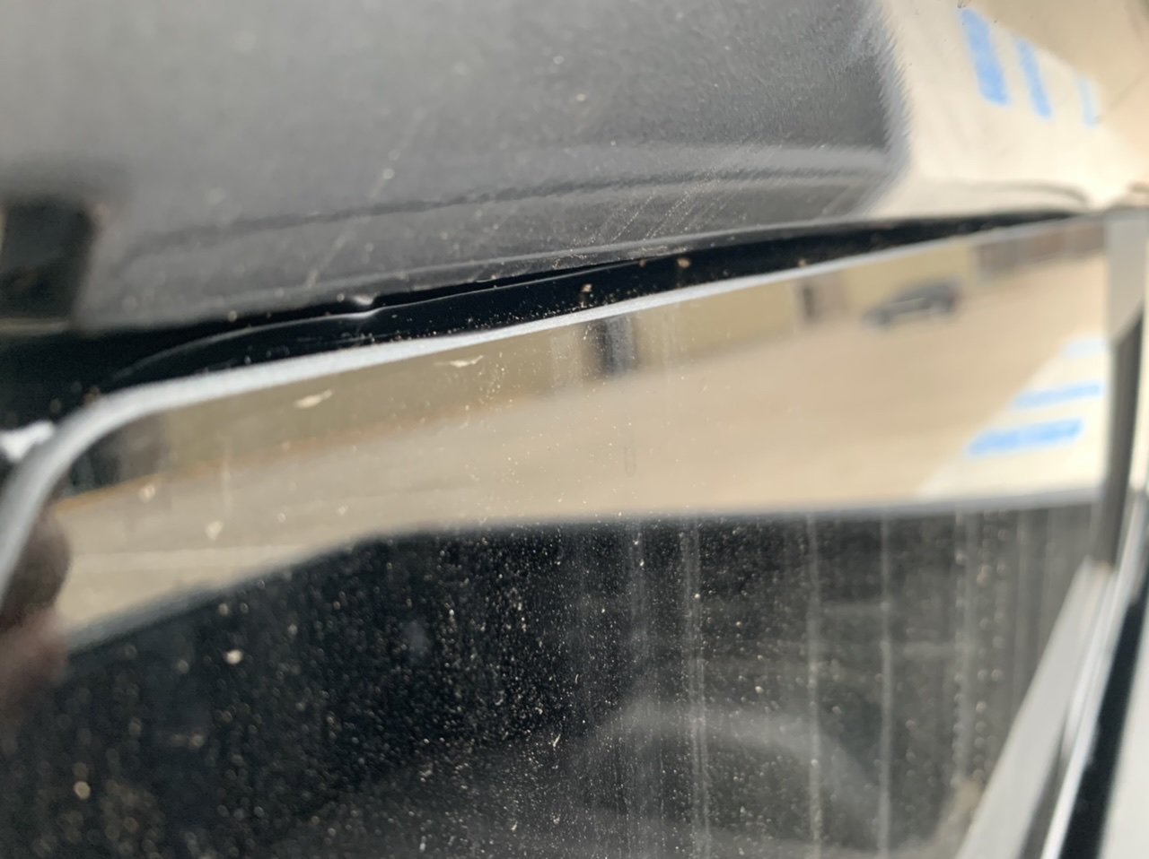

Well, that was quick. Dropped my truck off at 9:15am and had it back at 4:15pm.
2 recalls, rear squeaky brake checked (they were unable to replicate ?), tires rotated and... sealant applied to top of rear window.
They said they followed the TSB instructions for it and were not able to get it to leak after applying the new sealant (sounds... familiar).
The tech did a pretty good job. Some smudgy hand marks on top of my spoiler on the roof, but they didn’t run the truck through the wash before I picked it up.
Here’s a pic. It’s a consistent application of sealant across the whole top of the window.
So we shall see. There’s been a lot of AM condensation here lately, and my truck is parked on an incline, so I will know quickly if it’s leaking. ??
Same experience here with mine today and looks almost the same too. Dropped it off at 8am, picked up just after noon. They did clean work on mine, can barely see without looking in channel the added sealant. Tried to get a picture, but couldn't as it is hard to see. It smells just like what Safelite uses when replacing windshields and that is some strong stuff. Can't tell they were even inside the cab. I would take pics, but there is nothing to see, both inside and outside. Really hope this is the end for me, but we'll see.

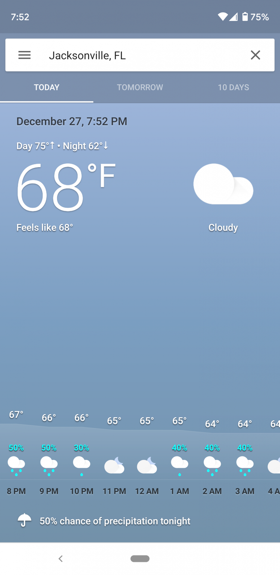

Well, about 7 or 8 hours later and it's getting tested tonight.
Well, all dry this morning, keeping fingers crossed.
