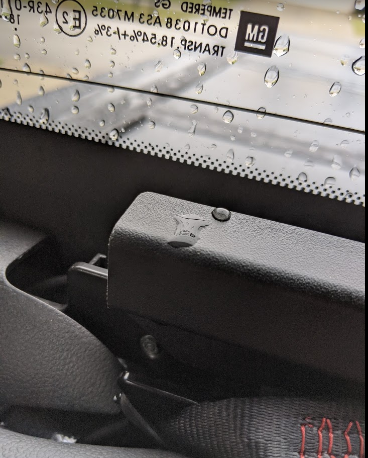

It looks like they only sealed one side. That’s not right. Looks like shit. I’d refuse delivery and argue for a new window. Ugh..
4 hours ago, SamDSJR said:
So should I reject this as acceptable work? Or take it and then take it back in to open a new ticket? I'm not sure what is best. At this point I fully intend to write certified letters to GM and attempt to get the buyback process initiated.
I wouldn’t even try for a buyback yet, you want to hang onto that card. And besides, crappy as it is, there’s just not enough there that would even make GM consider it, no matter the lawyer.
You can push for a new window and might get through, but I see the sealant reside on the paint as a big problem either way. Very disappointing.
I took mine back in less than stellar condition because it was a holiday weekend and I needed out of the loaner. Nothing stopping you from accepting it and still making follow up appointments and / or discussing things further with the service manager. What the dealer is willing to do would dictate my next move. Good luck.

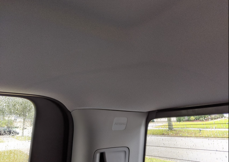

Just found this forum after finding a leak in my rear window. I have a 2019 Sierra 1500. I purchased this new truck after having a 2004 Sierra for 13 years. I"m not really that concerned with the window leak. I hope the dealership will get that taken care of. I'm worried about problems the water getting on the inside of the vehicle can cause. I had the truck for a couple of weeks before I got in it one morning and noticed a bad oder like wet carpet. I investigated and could find nothing. It happened again and again over the next several weeks. I have found the issue with wet carpet just inside the drivers side rear door. I have found water leaking down the inside of the rear widow on left and right sides. Will the dealer replace my carpet that now smells terrible? I've also noticed surface rust on the rear seat brackets and what looks like corrosion on some of the bolt heads. I've got an appointment with the service department early in January and I'm going to be armed with as much information as I can get my hands on. Thanks for all the education this thread has given me.

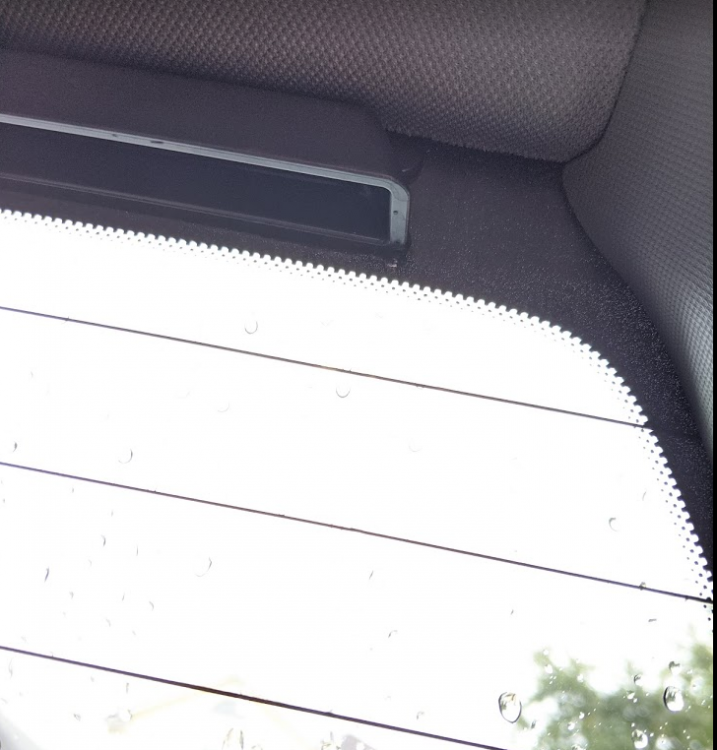

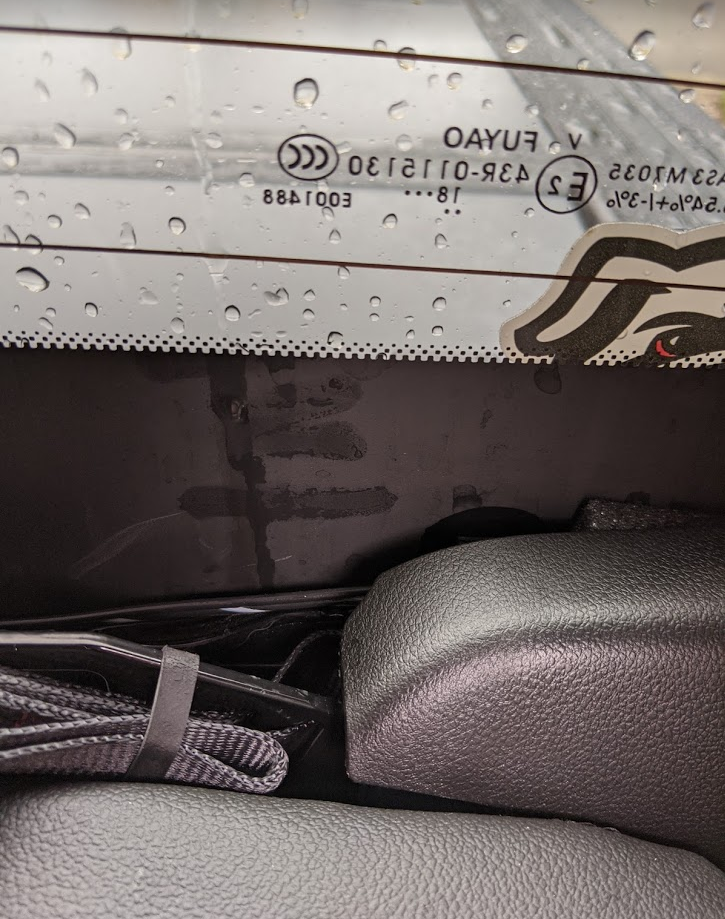

Now add me to the list. I've been inspecting like a hawk since I bought the truck in March after every wash and rain storm. It is a Nov 29, 2018 build, so I thought I was safe. We had about 5" of rain in the last 24 hours in Jacksonville. I am only now seeing some drips out of each corner of the top track and a stain on the passenger side headliner. Have a appt with the dealer for Friday. He said the leaks are very common these days and 99% of them lately are due to a bad seal on the spoiler/3rd break light. They have been changing a lot of those seals and sometime the light as well he said. He said they have also been successful cleaning the headliners and not needing to replace them with a certain cleaner supplied by GM for this.
Pass side:
Drivers side:
Drivers side:
